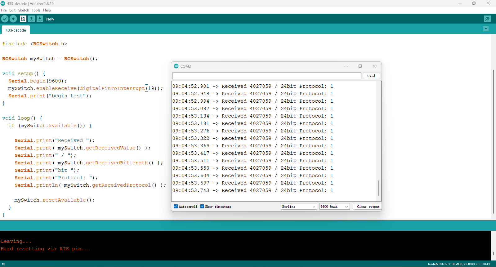

[arduino code examples for MT4]-01 433MHz RF receiver
  Simple example for receiving
  https://github.com/sui77/rc-switch/
#include <RCSwitch.h>
void setup() {
  Serial.begin(9600);
  mySwitch.enableReceive(digitalPinToInterrupt(38));
  Serial.print("begin test");
void loop() {
  if (mySwitch.available()) {
    Serial.print("Received ");
    Serial.print(" / ");
    Serial.print("bit ");
    Serial.print("Protocol: ");
    mySwitch.resetAvailable();
arduino ino file download:
.zip   433-decode.zip (Size: 451 bytes / Downloads: 189)
BIN file (you can use esp32 download tool download to ESP32-S3 with address 0x0 then directly to use) download:
.zip   433-decode.ino.merged.zip (Size: 181.95 KB / Downloads: 167)
