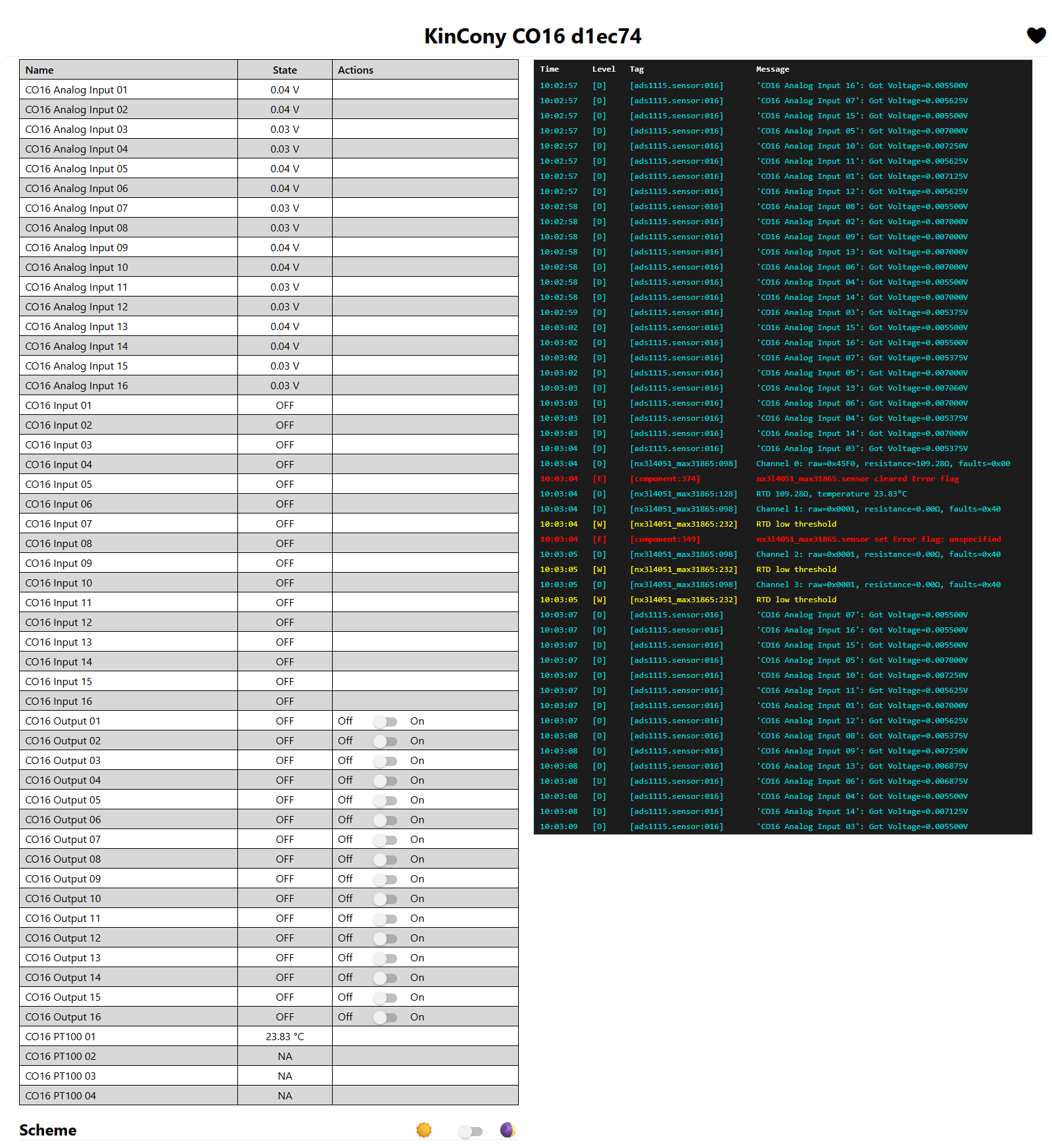

CO16 ESPHome yaml for home assistant without tuya
  friendly_name: KinCony CO16
  name_add_mac_suffix: true
  min_version: 2026.5.3
