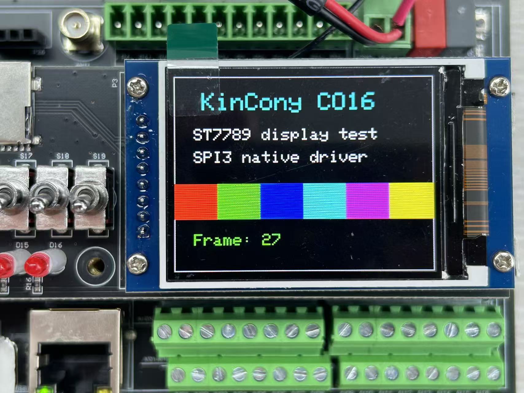

[arduino code examples for CO16]-10 ST7789 TFT color display

  display.print("KinCony CO16");
  display.setTextColor(kWhite);
  display.setTextSize(2);
  display.setCursor(24, 64);
  display.print("ST7789 display test");
  display.setCursor(24, 92);
  display.print("SPI3 native driver");
  drawColorBars();

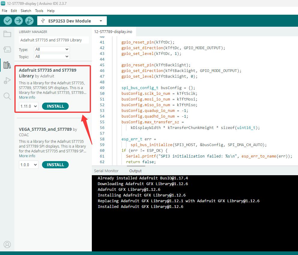

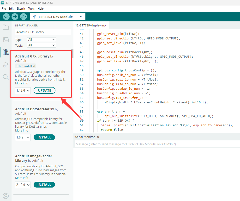

before run code , need install these arduino library:
