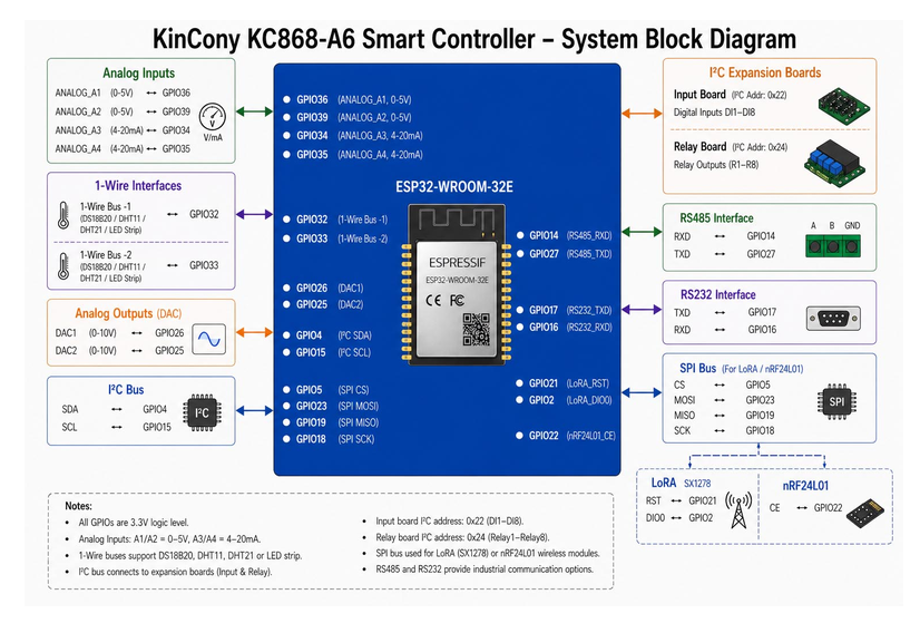

Hi. What is the situation regarding the analog inputs on the KC868-A6? Are all four 0–5V, or are two 0–5V and two 4–20mA? The reason I ask is that the system block diagram labels two as 0–5V and two as 4–20mA inputs, whereas the wiring diagram shows all four as 0–5V inputs.
4 channel are 0-5v analog input.

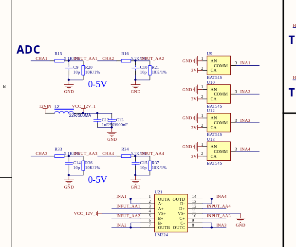

(09-28-2026, 12:52 PM)admin Wrote: 4 channel are 0-5v analog input.
That’s what I thought, too, based on the quad op-amp in the schematic. Thanks for the quick reply.
