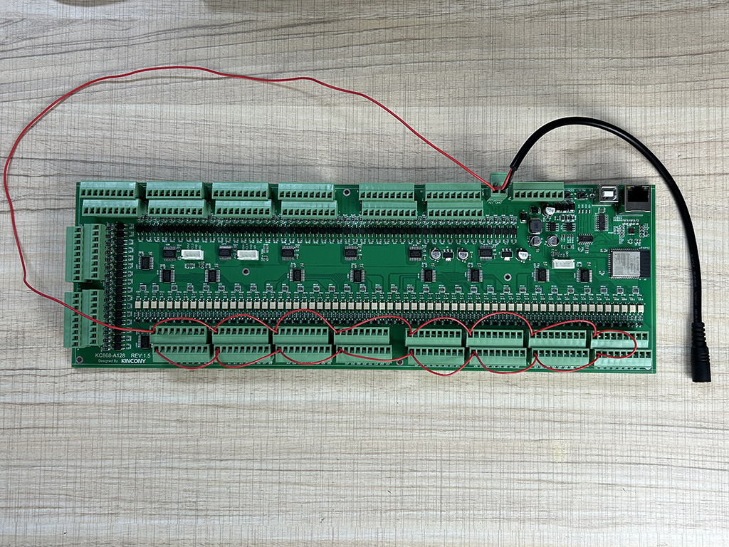

  Made by KinCony IoT: https://www.kincony.com<br />
<br />
  KC868-A128 - 128-channel light show for YouTube Shorts.<br />
<br />
  Effects:<br />
  1. Meteor chase with an 8-channel tail.<br />
  2. Two lights collide and move apart.<br />
  3. Four synchronized chase groups.<br />
  4. Fill and empty all 128 channels.<br />
  5. Odd/even alternation and a flashing finale.<br />
<br />
  Required library:<br />
  PCF8575 by Renzo Mischianti (xreef).<br />
<br />
  I2C SDA: GPIO5<br />
  I2C SCL: GPIO16<br />
<br />
  Outputs are active LOW.<br />
  Use the onboard LEDs or suitable demonstration lights.<br />
  The sequence includes stages with all outputs ON.<br />

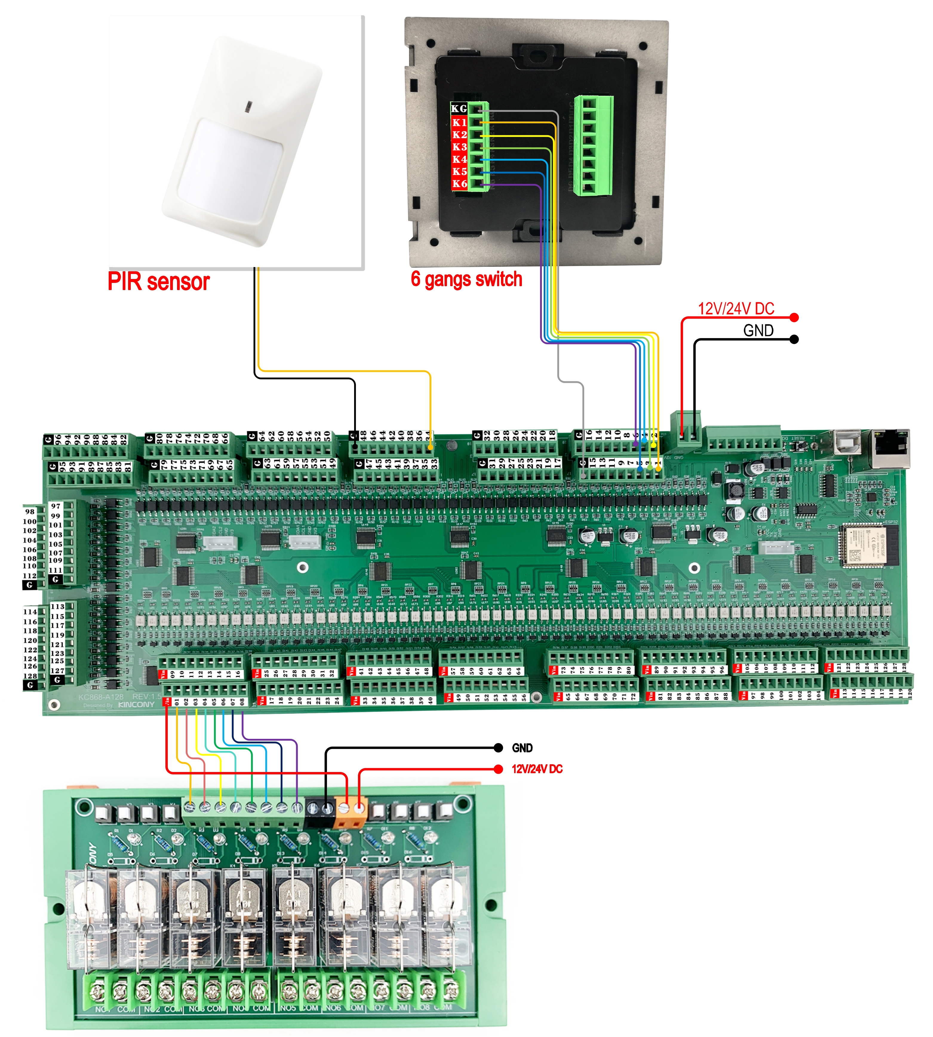

			<description><![CDATA[<!-- start: postbit_attachments_attachment -->
<br /><!-- start: attachment_icon -->
<img src="https://www.kincony.com/forum/images/attachtypes/image.png" title="JPG Image" border="0" alt=".jpg" />
<!-- end: attachment_icon -->&nbsp;&nbsp;<a href="attachment.php?aid=10025" target="_blank" title="">A128-DI-DO.jpg</a> (Size: 361.83 KB / Downloads: 238)
<!-- end: postbit_attachments_attachment --><br />
<div class="codeblock"><div class="title">Code:</div><div class="body" dir="ltr"><code>/*<br />
<br />
  KC868-A128<br />
  DI1 -&gt; DO1<br />
  DI2 -&gt; DO2<br />
  ...<br />
  DI128 -&gt; DO128<br />
<br />
  IIC Bus-A for relay DO:<br />
  SDA = GPIO5<br />
  SCL = GPIO16<br />
<br />
  IIC Bus-B for DI:<br />
  SDA = GPIO15<br />
  SCL = GPIO4<br />
*/<br />

			<content:encoded><![CDATA[<!-- start: postbit_attachments_attachment -->
<br />
  KC868-A128<br />
  DI1 -&gt; DO1<br />
  DI2 -&gt; DO2<br />
  ...<br />
<br />
  SDA = GPIO5<br />
  SCL = GPIO16<br />
<br />
  SDA = GPIO15<br />
  SCL = GPIO4<br />
*/<br />
<!-- end: attachment_icon -->&nbsp;&nbsp;<a href="attachment.php?aid=7739" target="_blank" title="">A128-input-toggle-output.jpg</a> (Size: 404.96 KB / Downloads: 673)
<img src="https://www.kincony.com/forum/images/attachtypes/image.png" title="PNG Image" border="0" alt=".png" />
<!-- end: attachment_icon -->&nbsp;&nbsp;<a href="attachment.php?aid=7740" target="_blank" title="">A128-esphome-automation.png</a> (Size: 135.48 KB / Downloads: 765)
<div class="codeblock"><div class="title">Code:</div><div class="body" dir="ltr"><code>esphome:<br />
