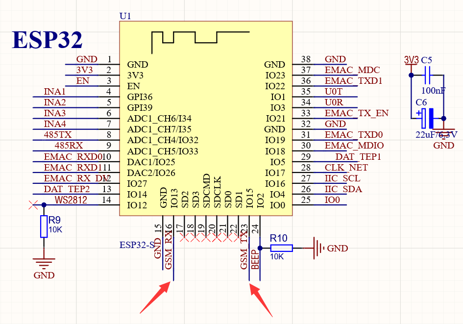

GPIO13 and GPIO15. here is diagram

board KC868-A2-V2.5 -  all the same?
#17
just the GSM pin define should be:
tx_pin: GPIO5
rx_pin: GPIO13
