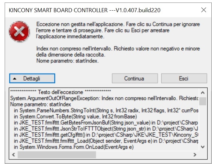

COL - start index error
Hello, after creating some rules in the IFTTT page I got this error message you see in the image. it looks like something related to the name. it just does it to me with IFTTT number 3 and 4. how can i solve?
press "details" , copy all information in a TXT file, upload at here.
thanks for the support, you are always very helpful.
I am attaching the file, I have translated the part in Italian into English.
.txt   Nuovo documento di testo.txt (Size: 5.91 KB / Downloads: 628)
have you by chance discovered something?
can you record your screen video. now not enough information. i don't know what you have operated, then have problem.
before you record video, delete all command firstly, then step by step to add, will see the problem in which step.
I made a video, here is the link:
https://drive.google.com/file/d/1OQ9S8eB...sp=sharing
ok, we will check.
we have checked, no this problem, i think you can use another computer running software for a test.
I re-downloaded the program "kincony scb" and the problem is gone. I assume it was caused by a name I gave to a command.
