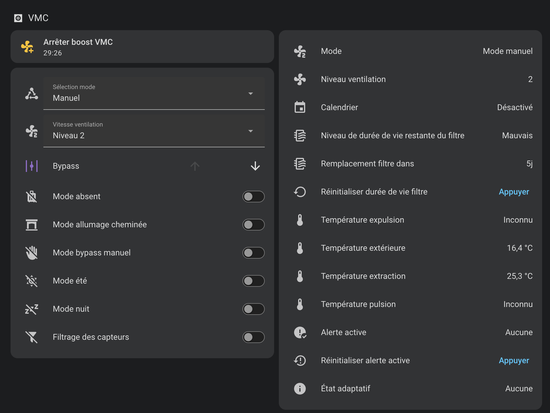

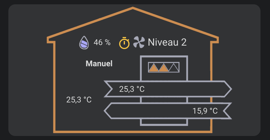

My VMC has an RJ45 port, useful to integrate it in Home Assistant. I don't see one on the plan, it could be good to include it just in case.
