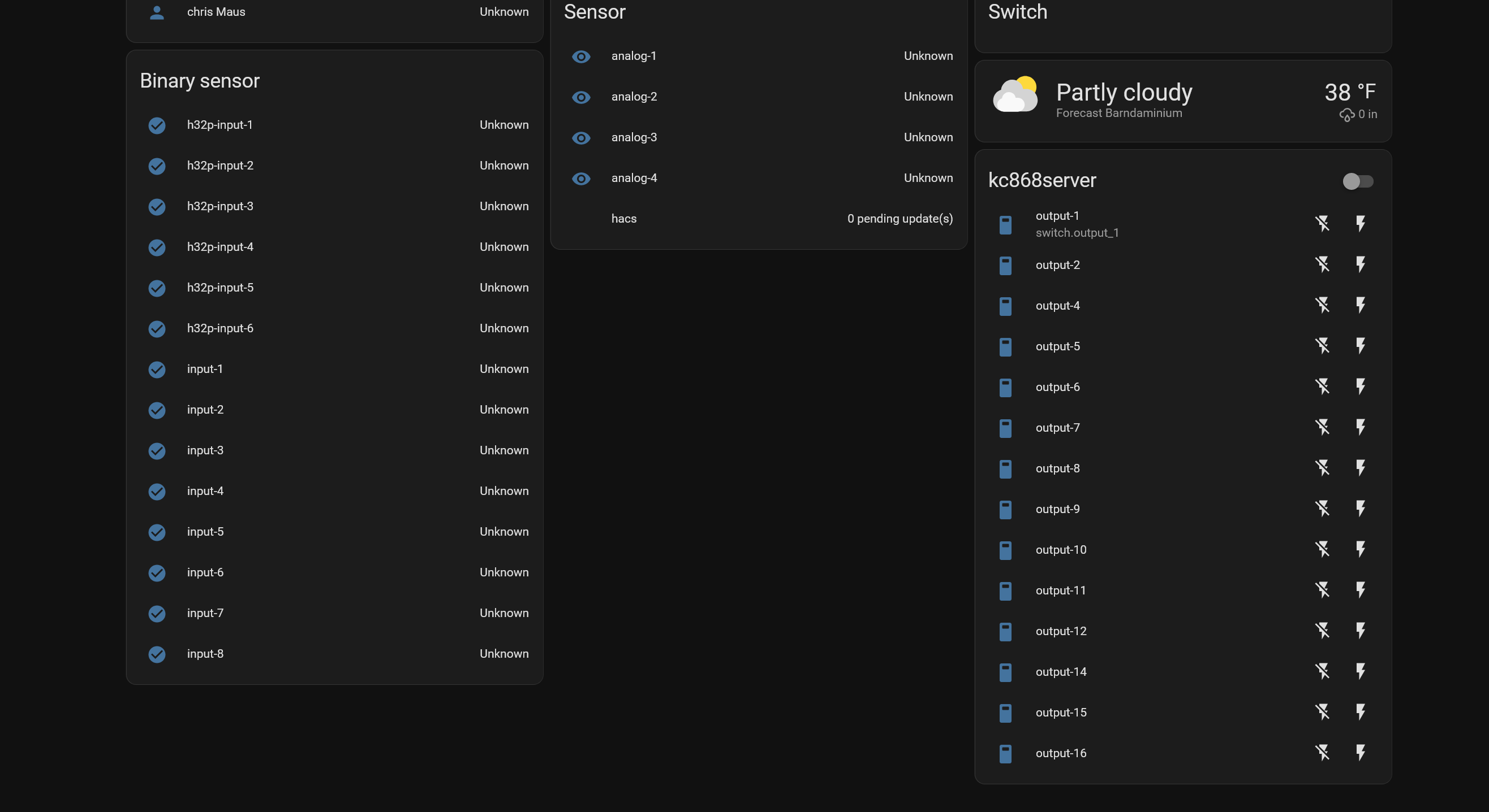

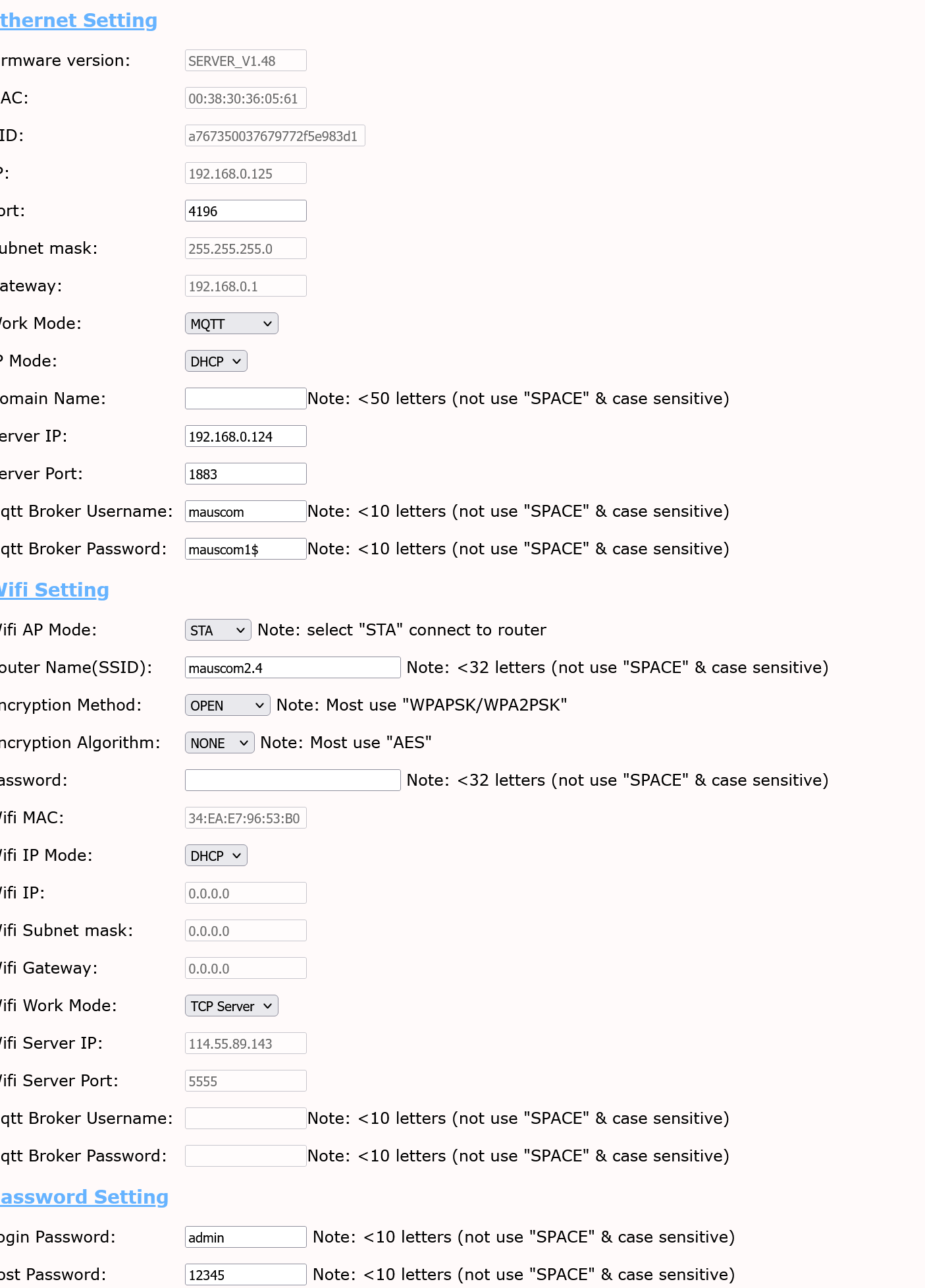

I got it all to show in overview, but it does nothing to the leds.
yaml is good, server setup is good, mqtt config is good, all are aligned... use no good.

try to replace your password: Mauscom1$ not use "$" for a test. such as password= Mauscom1
still not helping the situation.
(02-26-2023, 04:11 AM)admin Wrote: [ -> ]try to replace your password: Mauscom1$ not use "$" for a test. such as password= Mauscom1

The same problem above with (member Mauscom) KC868-Server 16 channel output, 16 channel digital input, 4 channel analog input all use in configuration.yaml
It happens with the exact same pictures shown above.
show "unknow" in dashboard?
