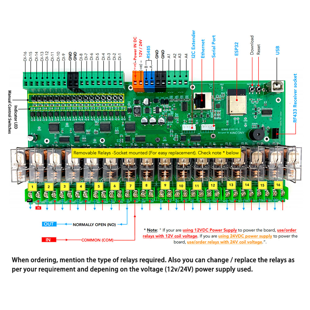

05-17-2022, 12:45 AM
platform: ESP32
board: esp32dev
i2c:
sda: 16
scl: 15
scan: true
# Example configuration entry
ethernet:
type: LAN8720
mdc_pin: GPIO23
mdio_pin: GPIO18
clk_mode: GPIO17_OUT
phy_addr: 0
# Optional manual IP
# manual_ip:
# static_ip: 192.168.1.199
# gateway: 192.168.1.1
# subnet: 255.255.255.0
pcf8574:
- id: 'pcf8574_hub_out_1' # for output channel 1-8
address: 0x21
- id: 'pcf8574_hub_out_2' # for output channel 9-16
address: 0x25
- id: 'pcf8574_hub_in_1' # for input channel 1-8
address: 0x22
- id: 'pcf8574_hub_in_2' # for input channel 9-16
address: 0x24
# Individual outputs
- platform: gpio
pin:
pcf8574: pcf8574_hub_out_1
number: 0
mode: OUTPUT
inverted: true
- platform: gpio
pin:
number: 1
mode: OUTPUT
inverted: true
- platform: gpio
pin:
number: 2
mode: OUTPUT
inverted: true
- platform: gpio
pin:
number: 3
mode: OUTPUT
inverted: true
- platform: gpio
pin:
number: 4
mode: OUTPUT
inverted: true
- platform: gpio
pin:
number: 5
mode: OUTPUT
inverted: true
- platform: gpio
pin:
number: 6
mode: OUTPUT
inverted: true
- platform: gpio
pin:
number: 7
mode: OUTPUT
inverted: true
- platform: gpio
pin:
pcf8574: pcf8574_hub_out_2
number: 0
mode: OUTPUT
inverted: true
- platform: gpio
pin:
number: 1
mode: OUTPUT
inverted: true
- platform: gpio
pin:
number: 2
mode: OUTPUT
inverted: true
- platform: gpio
pin:
number: 3
mode: OUTPUT
inverted: true
- platform: gpio
pin:
number: 4
mode: OUTPUT
inverted: true
- platform: gpio
pin:
number: 5
mode: OUTPUT
inverted: true
- platform: gpio
pin:
number: 6
mode: OUTPUT
inverted: true
- platform: gpio
pin:
number: 7
mode: OUTPUT
inverted: true
binary_sensor:
- platform: gpio
pin:
pcf8574: pcf8574_hub_in_1
number: 0
mode: INPUT
inverted: true
- platform: gpio
pin:
number: 1
mode: INPUT
inverted: true
- platform: gpio
pin:
number: 2
mode: INPUT
inverted: true
- platform: gpio
pin:
number: 3
mode: INPUT
inverted: true
- platform: gpio
pin:
number: 4
mode: INPUT
inverted: true
- platform: gpio
pin:
number: 5
mode: INPUT
inverted: true
- platform: gpio
pin:
number: 6
mode: INPUT
inverted: true
- platform: gpio
pin:
number: 7
mode: INPUT
inverted: true
- platform: gpio
pin:
pcf8574: pcf8574_hub_in_2
number: 0
mode: INPUT
inverted: true
- platform: gpio
pin:
number: 1
mode: INPUT
inverted: true
- platform: gpio
pin:
number: 2
mode: INPUT
inverted: true
- platform: gpio
pin:
number: 3
mode: INPUT
inverted: true
- platform: gpio
pin:
number: 4
mode: INPUT
inverted: true
- platform: gpio
pin:
number: 5
mode: INPUT
inverted: true
- platform: gpio
pin:
number: 6
mode: INPUT
inverted: true
- platform: gpio
pin:
number: 7
mode: INPUT
inverted: true
# Enable Home Assistant API
