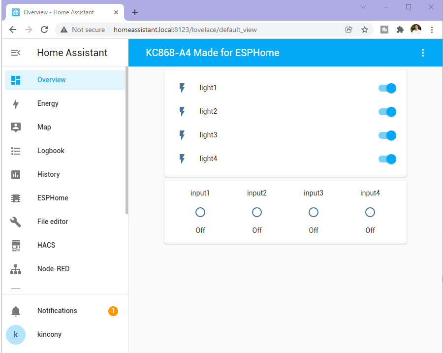

07-16-2022, 01:19 PM
platform: ESP32
board: esp32dev
# Enable Home Assistant API
ota:
password: "4d5a388de4f759bf88e71cde7a31af6f"
wifi:
ssid: "KinCony"
password: "a12345678"
ap:
ssid: "Kc868-A4 Fallback Hotspot"
password: "QOU4hbAjJ5Wb"
captive_portal:
- platform: gpio
pin: 2
inverted: false
- platform: gpio
pin: 15
inverted: false
- platform: gpio
pin: 5
inverted: false
- platform: gpio
pin: 4
inverted: false
binary_sensor:
- platform: gpio
pin:
number: 36
inverted: true
- platform: gpio
pin:
number: 39
inverted: true
- platform: gpio
pin:
number: 27
inverted: true
- platform: gpio
pin:
number: 14
inverted: true
[attachment=1127]
[attachment=1128]
