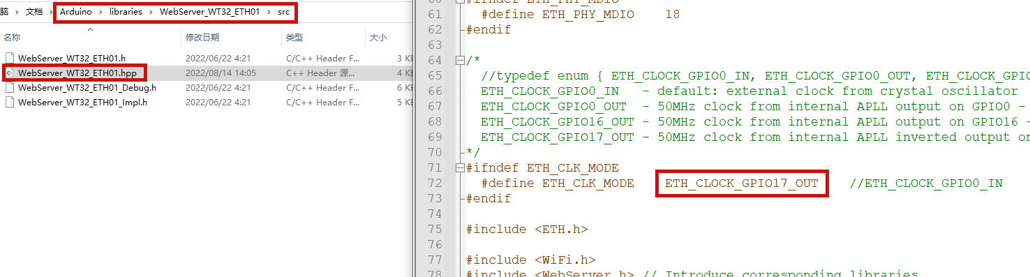

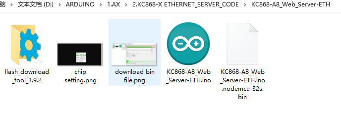

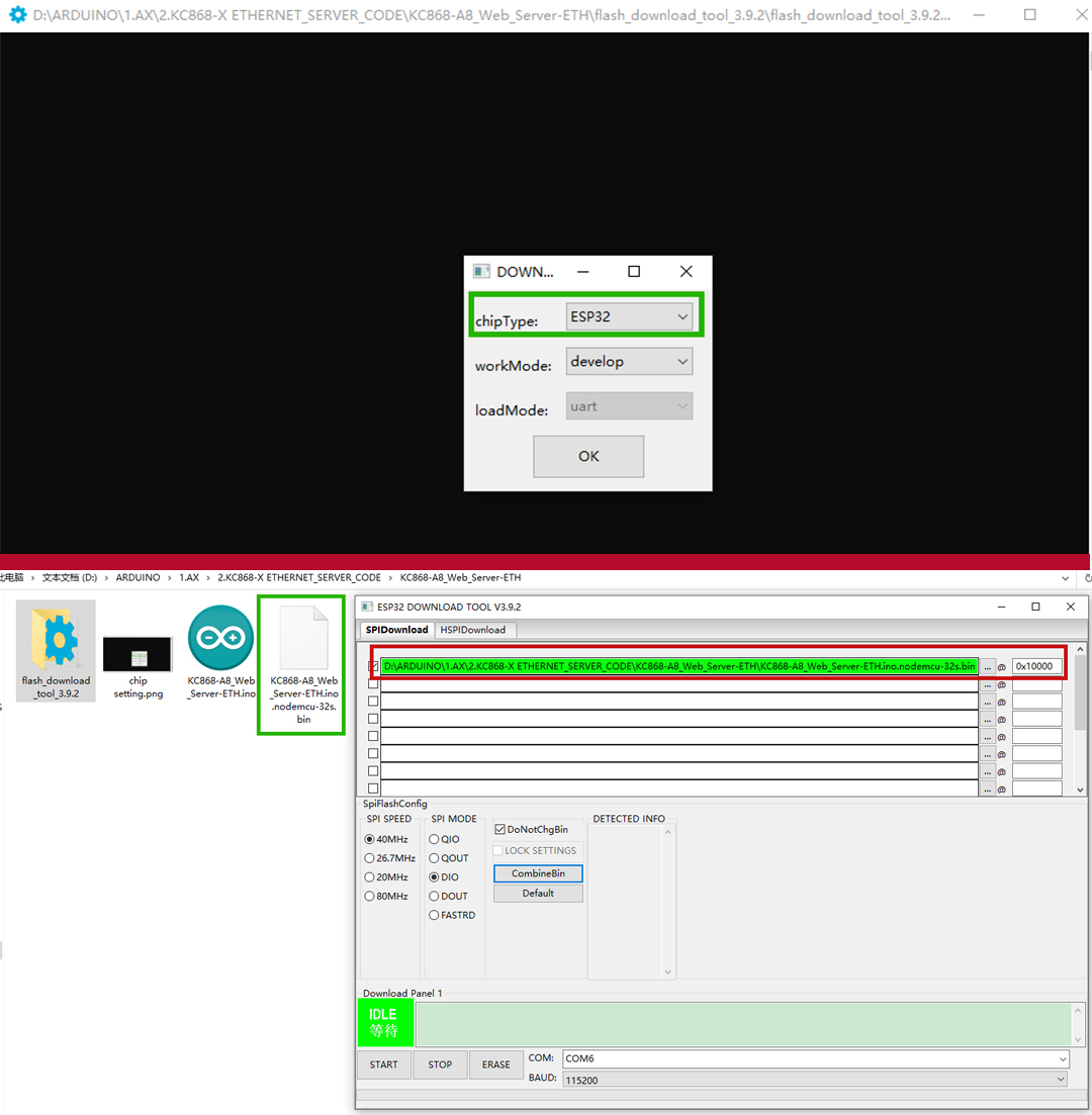

[attachment=1336]
[attachment=1345]
[attachment=1340]
[attachment=1336]
[attachment=1345]
[attachment=1340]
