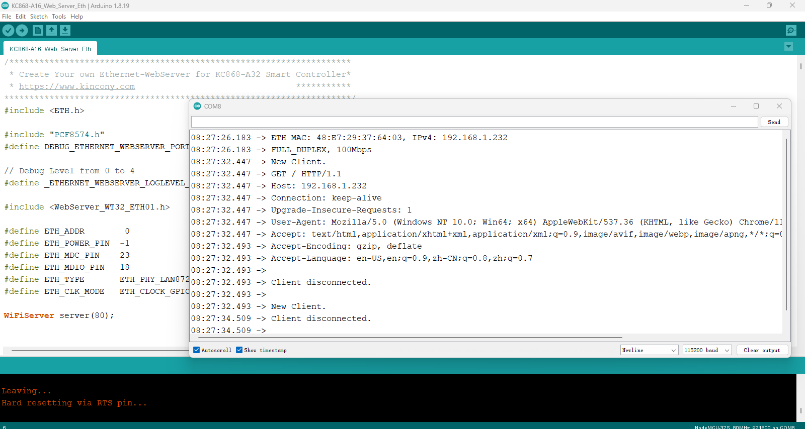

Full Version: [Arduino IDE demo source code for KC868-A16]--#11-KC868-A16_Ethernet_Web_server_code
Pages: 1 2
                      Refer to code #11 of A8 for download methods
[attachment=1406]
* Create Your own Ethernet-WebServer for KC868-A32 Smart Controller*

i want download web server fireware for kc868 A16 and rigest alexa
you can use our "KCS" firmware.
update newest code at here:
* https://www.kincony.com                                ***********
#include <ETH.h>
#include "PCF8574.h"
#define DEBUG_ETHERNET_WEBSERVER_PORT       Serial
// Debug Level from 0 to 4
#define _ETHERNET_WEBSERVER_LOGLEVEL_       3
#include <WebServer_WT32_ETH01.h>
#define ETH_ADDR        0
#define ETH_POWER_PIN  -1
#define ETH_MDC_PIN    23
#define ETH_MDIO_PIN   18
#define ETH_TYPE       ETH_PHY_LAN8720
#define ETH_CLK_MODE   ETH_CLOCK_GPIO17_OUT
WiFiServer server(80);
// Select the IP address according to your local network
IPAddress myIP(192, 168, 1, 232);
IPAddress myGW(192, 168, 1, 1);
IPAddress mySN(255, 255, 255, 0);
// Google DNS Server IP
IPAddress myDNS(8, 8, 8, 8);
// Current time
// Previous time
int flag_read_di=0;
String header;
TwoWire I2Cone = TwoWire(0);
//TwoWire I2Ctwo = TwoWire(1);
// Set relay output i2c address
PCF8574 pcf8574_R1(&I2Cone, 0x24, 4, 5);
PCF8574 pcf8574_R2(&I2Cone, 0x25, 4, 5);
//PCF8574 pcf8574_R3(&I2Ctwo, 0x21, 15, 13);
//PCF8574 pcf8574_R4(&I2Ctwo, 0x22, 15, 13);
PCF8574 pcf8574_I1(&I2Cone, 0x21, 4, 5);
PCF8574 pcf8574_I2(&I2Cone, 0x22, 4, 5);
//PCF8574 pcf8574_I3(&I2Cone, 0x21, 4, 5);
//PCF8574 pcf8574_I4(&I2Cone, 0x22, 4, 5);
String relay32state = "off";// state of relay32*/
void setup()
  Serial.begin(115200);
pcf8574_R1.pinMode(P0, OUTPUT);
pcf8574_R1.pinMode(P1, OUTPUT);
pcf8574_R1.pinMode(P2, OUTPUT);
pcf8574_R1.pinMode(P3, OUTPUT);
pcf8574_R1.pinMode(P4, OUTPUT);
pcf8574_R1.pinMode(P5, OUTPUT);
pcf8574_R1.pinMode(P6, OUTPUT);
pcf8574_R1.pinMode(P7, OUTPUT);
pcf8574_R2.pinMode(P0, OUTPUT);
pcf8574_R2.pinMode(P1, OUTPUT);
pcf8574_R2.pinMode(P2, OUTPUT);
pcf8574_R2.pinMode(P3, OUTPUT);
pcf8574_R2.pinMode(P4, OUTPUT);
pcf8574_R2.pinMode(P5, OUTPUT);
pcf8574_R2.pinMode(P6, OUTPUT);
pcf8574_R2.pinMode(P7, OUTPUT);
pcf8574_R3.pinMode(P0, OUTPUT);
pcf8574_R3.pinMode(P1, OUTPUT);
pcf8574_R3.pinMode(P2, OUTPUT);
pcf8574_R3.pinMode(P3, OUTPUT);
pcf8574_R3.pinMode(P4, OUTPUT);
pcf8574_R3.pinMode(P5, OUTPUT);
pcf8574_R3.pinMode(P6, OUTPUT);
pcf8574_R3.pinMode(P7, OUTPUT);
pcf8574_R4.pinMode(P0, OUTPUT);
pcf8574_R4.pinMode(P1, OUTPUT);
pcf8574_R4.pinMode(P2, OUTPUT);
pcf8574_R4.pinMode(P3, OUTPUT);
pcf8574_R4.pinMode(P4, OUTPUT);
pcf8574_R4.pinMode(P5, OUTPUT);
pcf8574_R4.pinMode(P6, OUTPUT);
pcf8574_R4.pinMode(P7, OUTPUT);*/
  Serial.print("Init pcf8574_R1...");
  if (pcf8574_R1.begin()){
    Serial.println("PCF8574_R1_OK");
  }else{
    Serial.println("PCF8574_R1_KO");
  Serial.print("Init pcf8574_R2...");
  if (pcf8574_R2.begin()){
    Serial.println("PCF8574_R2_OK");
  }else{
    Serial.println("PCF8574_R2_KO");
  Serial.print("Init pcf8574_R3...");
  if (pcf8574_R3.begin()){
    Serial.println("PCF8574_R3_OK");
  }else{
    Serial.println("PCF8574_R3_KO");
  Serial.print("Init pcf8574_R4...");
  if (pcf8574_R4.begin()){
    Serial.println("PCF8574_R4_OK");
  }else{
    Serial.println("PCF8574_R4_KO");
pcf8574_I1.pinMode(P0, INPUT);
pcf8574_I1.pinMode(P1, INPUT);
pcf8574_I1.pinMode(P2, INPUT);
pcf8574_I1.pinMode(P3, INPUT);
pcf8574_I1.pinMode(P4, INPUT);
pcf8574_I1.pinMode(P5, INPUT);
pcf8574_I1.pinMode(P6, INPUT);
pcf8574_I1.pinMode(P7, INPUT);
pcf8574_I2.pinMode(P0, INPUT);
pcf8574_I2.pinMode(P1, INPUT);
pcf8574_I2.pinMode(P2, INPUT);
pcf8574_I2.pinMode(P3, INPUT);
pcf8574_I2.pinMode(P4, INPUT);
pcf8574_I2.pinMode(P5, INPUT);
pcf8574_I2.pinMode(P6, INPUT);
pcf8574_I2.pinMode(P7, INPUT);
pcf8574_I3.pinMode(P0, INPUT);
pcf8574_I3.pinMode(P1, INPUT);
pcf8574_I3.pinMode(P2, INPUT);
pcf8574_I3.pinMode(P3, INPUT);
pcf8574_I3.pinMode(P4, INPUT);
pcf8574_I3.pinMode(P5, INPUT);
pcf8574_I3.pinMode(P6, INPUT);
pcf8574_I3.pinMode(P7, INPUT);
pcf8574_I4.pinMode(P0, INPUT);
pcf8574_I4.pinMode(P1, INPUT);
pcf8574_I4.pinMode(P2, INPUT);
pcf8574_I4.pinMode(P3, INPUT);
pcf8574_I4.pinMode(P4, INPUT);
pcf8574_I4.pinMode(P5, INPUT);
pcf8574_I4.pinMode(P6, INPUT);
pcf8574_I4.pinMode(P7, INPUT);*/
  Serial.print("Init pcf8574...");
  if (pcf8574_I1.begin()){
    Serial.println("pcf8574_I1_OK");
  }else{
    Serial.println("pcf8574_I1_KO");
  if (pcf8574_I2.begin()){
    Serial.println("pcf8574_I2_OK");
  }else{
    Serial.println("pcf8574_I2_KO");
  Serial.print("Init pcf8574_I3...");
  if (pcf8574_I3.begin()){
    Serial.println("pcf8574_I3_OK");
  }else{
    Serial.println("pcf8574_I3_KO");
  Serial.print("Init pcf8574_I4...");
  if (pcf8574_I4.begin()){
    Serial.println("pcf8574_I4_OK");
  }else{
    Serial.println("pcf8574_I4_KO");
  pcf8574_R1.digitalWrite(P0, HIGH);
  pcf8574_R1.digitalWrite(P1, HIGH);
  pcf8574_R1.digitalWrite(P2, HIGH);
  pcf8574_R1.digitalWrite(P3, HIGH);
  pcf8574_R1.digitalWrite(P4, HIGH);
  pcf8574_R1.digitalWrite(P5, HIGH);
  pcf8574_R1.digitalWrite(P6, HIGH);
  pcf8574_R1.digitalWrite(P7, HIGH);
  pcf8574_R2.digitalWrite(P0, HIGH);
  pcf8574_R2.digitalWrite(P1, HIGH);
  pcf8574_R2.digitalWrite(P2, HIGH);
  pcf8574_R2.digitalWrite(P3, HIGH);
  pcf8574_R2.digitalWrite(P4, HIGH);
  pcf8574_R2.digitalWrite(P5, HIGH);
  pcf8574_R2.digitalWrite(P6, HIGH);
  pcf8574_R2.digitalWrite(P7, HIGH);
  pcf8574_R3.digitalWrite(P0, HIGH);
  pcf8574_R3.digitalWrite(P1, HIGH);
  pcf8574_R3.digitalWrite(P2, HIGH);
  pcf8574_R3.digitalWrite(P3, HIGH);
  pcf8574_R3.digitalWrite(P4, HIGH);
  pcf8574_R3.digitalWrite(P5, HIGH);
  pcf8574_R3.digitalWrite(P6, HIGH);
  pcf8574_R3.digitalWrite(P7, HIGH);
  pcf8574_R4.digitalWrite(P0, HIGH);
  pcf8574_R4.digitalWrite(P1, HIGH);
  pcf8574_R4.digitalWrite(P2, HIGH);
  pcf8574_R4.digitalWrite(P3, HIGH);
  pcf8574_R4.digitalWrite(P4, HIGH);
  pcf8574_R4.digitalWrite(P5, HIGH);
  pcf8574_R4.digitalWrite(P6, HIGH);
  pcf8574_R4.digitalWrite(P7, HIGH);*/
  while (!Serial);
  // Using this if Serial debugging is not necessary or not using Serial port
  //while (!Serial && (millis() < 3000));
  Serial.print("\nStarting WebServer on " + String(ARDUINO_BOARD));
  Serial.println(" with " + String(SHIELD_TYPE));
  Serial.println(WEBSERVER_WT32_ETH01_VERSION);
  WT32_ETH01_onEvent();
  //bool begin(uint8_t phy_addr=ETH_PHY_ADDR, int power=ETH_PHY_POWER, int mdc=ETH_PHY_MDC, int mdio=ETH_PHY_MDIO,
  //           eth_phy_type_t type=ETH_PHY_TYPE, eth_clock_mode_t clk_mode=ETH_CLK_MODE);
  ETH.begin(ETH_PHY_ADDR, ETH_PHY_POWER, ETH_PHY_MDC, ETH_PHY_MDIO, ETH_PHY_TYPE, ETH_CLK_MODE);

[attachment=3047]
[attachment=3046]

All source is wrong for the ethernet
//ETH.begin(ETH_ADDR, ETH_POWER_PIN, ETH_MDC_PIN, ETH_MDIO_PIN, ETH_TYPE, ETH_CLK_MODE); //start with ETH wrong
ETH.begin(ETH_TYPE, ETH_ADDR, ETH_MDC_PIN, ETH_MDIO_PIN, ETH_POWER_PIN , ETH_CLK_MODE); //start with ETH right
