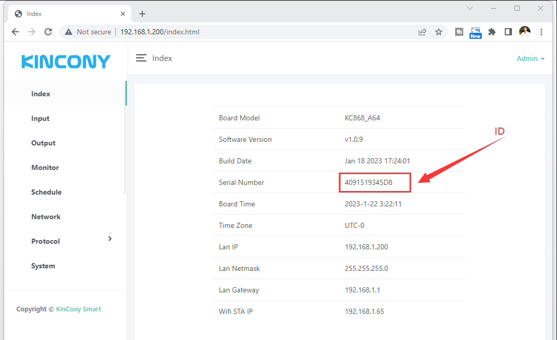

your state_topic and command_topic is wrong.
you only need add 16 DO and 16 DI command. The server topic because i have also added KC868-Server, you not need to use. so you need to 16 DO and 16 DI as these format:
- name: 'a16-kcs-output-1'
unique_id: a16-kcs-output-1
state_topic: 'KC868_A16/B48A0A404560/STATE' replace B48A0A404560 with your boad's ID, you can check in your board webpage.
command_topic: 'KC868_A16/B48A0A404560/SET' replace B48A0A404560 with your boad's ID, you can check in your board webpage.

02-13-2023, 12:19 AM
i have told you to use:
state_topic: 'KC868_A16/90380CA4382C/STATE'
command_topic: 'KC868_A16/90380CA4382C/SET'
but you are using: (it's mistake) Do you see it??
state_topic: 'KC868_a16/KC868_A16/90380CA4382C/STATE'
command_topic: 'KC868_a16/KC868_A16/90380CA4382C/SET'
