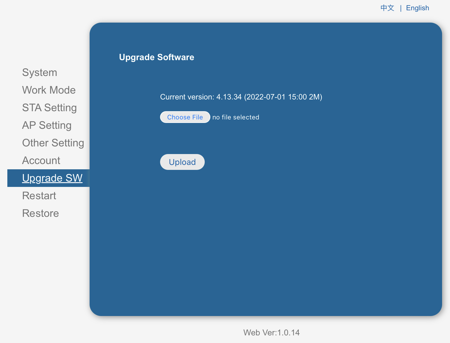

where is say the "firmware version 4.13.34" , take a photo. i think it's your wifi module's firmware version, not controller's firmware.
(03-06-2023, 10:32 PM)admin Wrote: [ -> ]where is say the "firmware version 4.13.34" , take a photo. i think it's your wifi module's firmware version, not controller's firmware.
[attachment=2080]
[attachment=2081]
If this is the Wi-Fi firmware how does one see the controllers firmware?

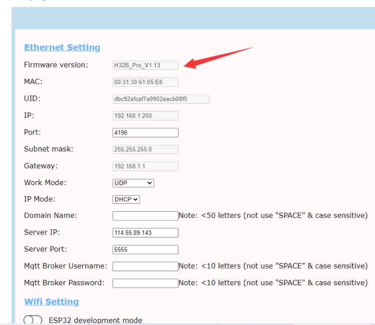

connect ethernet cable with your controller. open IP address in web browser, then you will see it.
[attachment=2082]

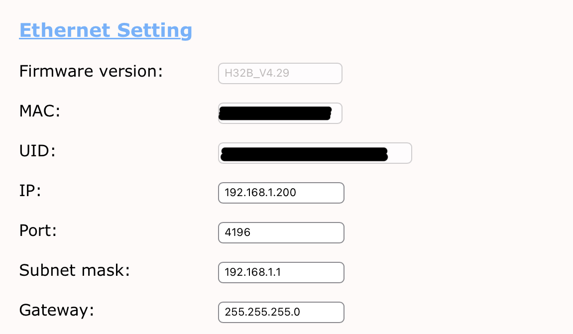

Would’ve helped to know that I needed to hold down the ethernet button until all the lights showed in order to turn it into TCP server static mode.
It shows version H32B_V4.29
Is  Relay32_V437_210907.zip a later version , from the numbering v437 looks later than v429 ?
At least I have access to the config , I assumed wrongly this would have been part of the web page available by Wi-Fi.
