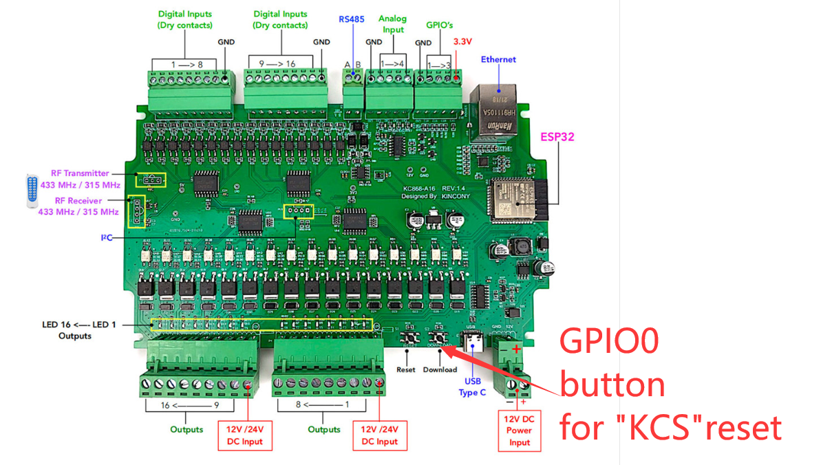

if you have download the "KCS" firmware. you can HOLD ON the GPIO0 button > 10 seconds. then board will be enable ethernet to DHCP. you can connect with your ethernet cable. use kincony scan deivce tool to find out the IP address of board.
scan device tool download: https://www.kincony.com/download/UDP_SCAN_LIST.zip
Where is the GPIO0 button, is that the RESET?
Thank you very much. Shy
Working just fine, I get access again from web browser!

you have config it use by WIFI, so can't use by ethernet. suggest you remove these command, use DHCP is better:
remove your code:
manual_ip:
static_ip: 192.168.1.200
gateway: 192.168.1.1
subnet: 255.255.255.0
