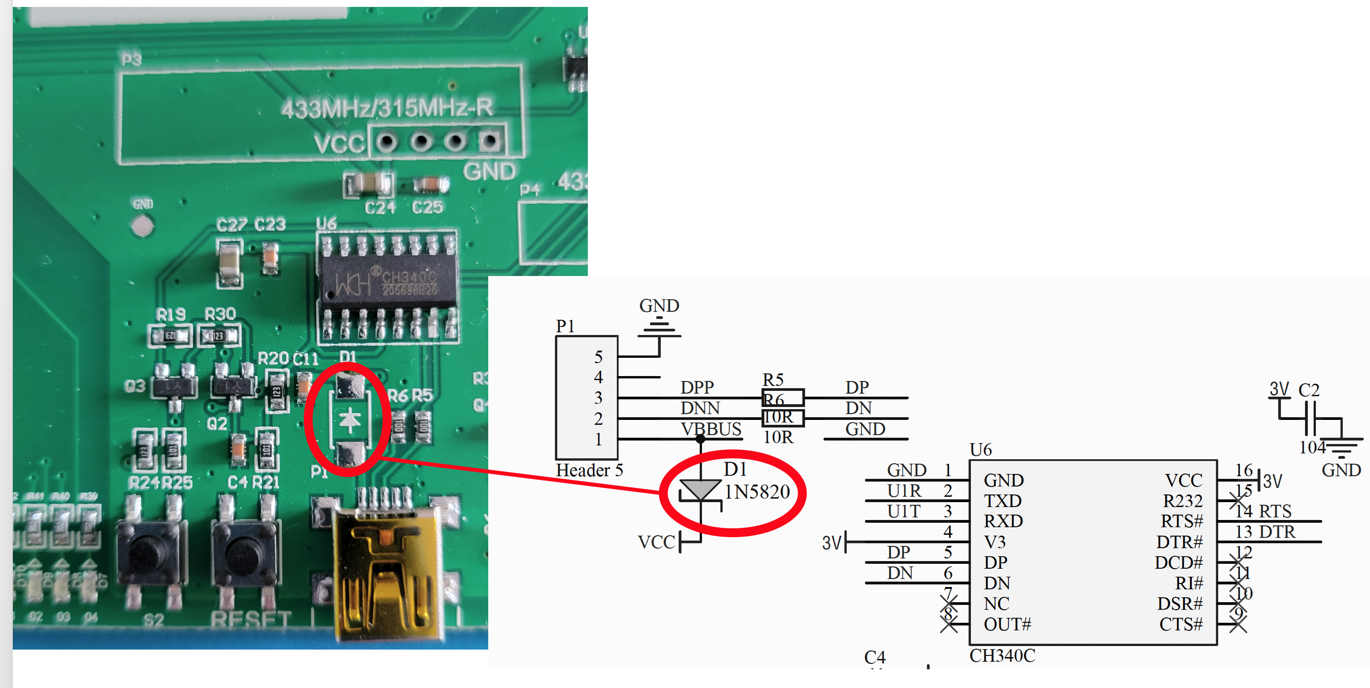

Hi, do I need to power the A4 with 12V for programming? Arduino IDE doesn't recognize the USB port
(04-14-2022, 12:35 PM)IvanPad Wrote: [ -> ]Hi, do I need to power the A4 with 12V for programming? Arduino IDE doesn't recognize the USB port
I see the USB power is isolated in my board, but it exists in the schema: [attachment=851]
Is that diode rquired to power esp32 for programming?
not need, it's normal.
(04-15-2022, 12:11 AM)admin Wrote: [ -> ]not need, it's normal.
Thank you @admin, OK the diode is not requrired, but Do I need to connect 12V power to program esp32? My pc doesn't recognize the USB port when I connect.
you should connect with DC12v power supply for board, only connect with USB port, no power.
