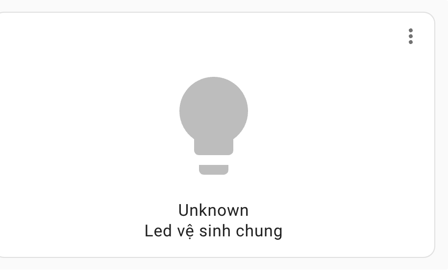

But if I create a "light",
light:
  - name: 'my_led'
    unique_id: a16-kcs-output-led-wc-1
    state_topic: 'KC868_A16/B0B21CCF0978/STATE'
    command_topic: 'KC868_A16/B0B21CCF0978/SET'
    state_value_template: '{{ value_json.output1.value }}'
the UI in home assistant showed "Unknown" status. [attachment=3105]
Please help!
i think you can use "switch", just change UI for "light" ico is better.
Thank you, it works!
(09-20-2023, 10:10 PM)admin Wrote: [ -> ]i think you can use "switch", just change UI for "light" ico is better.
But, if I have to do "light" in my config.yaml?
Please, help!!!
The topic is of course old, but maybe it will be useful to someone
  - light:
        schema: template
        unique_id: a6-kcs-1-output-2
        state_topic: 'KC868_A6/XXXXXXXXXX/STATE'
        command_topic: 'KC868_A6/XXXXXXXXXX/SET'
        command_off_template: '{"output2":{"value":false}}'
        command_on_template: '{"output2":{"value":true}}'
        state_template: '{{ iif (value_json.output2.value == true , "on", "off") }}'
thanks share your code.
