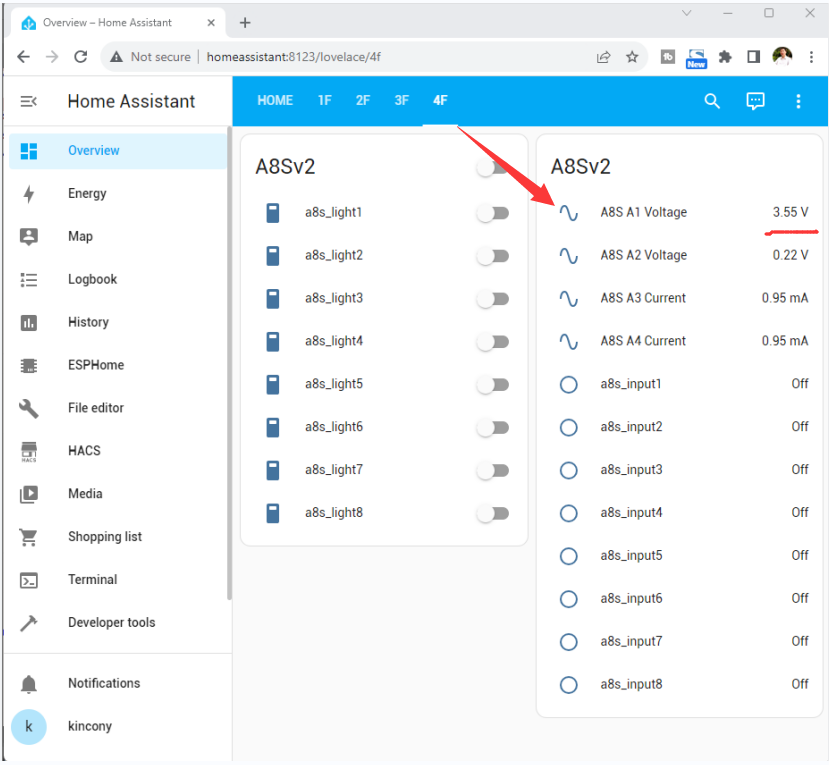

10-27-2023, 02:43 AM
[attachment=3307]
[attachment=3308]
sensor:
- platform: adc
pin: 36
name: "A8S A1 Voltage"
update_interval: 5s
attenuation: 11db
filters:
- lambda:
if (x >= 3.11) {
return x * 1.60256;
} else if (x <= 0.15) {
return 0;
} else {
return x * 1.51;
- platform: adc
pin: 34
name: "A8S A2 Voltage"
update_interval: 5s
attenuation: 11db
filters:
# - multiply: 1.51515
- lambda:
if (x >= 3.11) {
return x * 1.60256;
return 0;
} else {
return x * 1.51;
- platform: adc
pin: 35
name: "A8S A3 Current"
update_interval: 5s
unit_of_measurement: mA
attenuation: 11db
filters:
- multiply: 6.66666666
- platform: adc
pin: 39
name: "A8S A4 Current"
update_interval: 5s
attenuation: 11db
filters:
