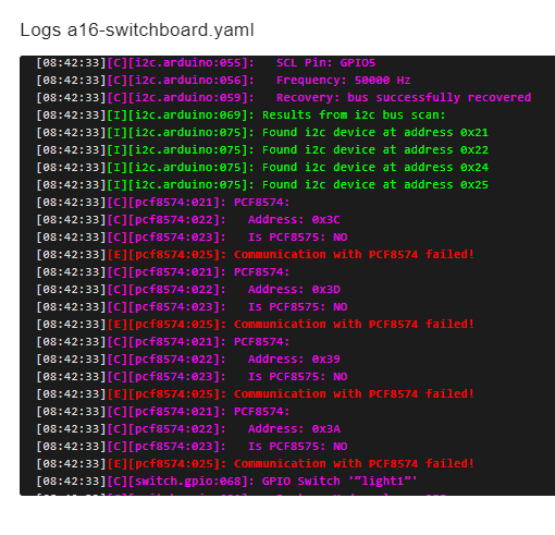

When changed the I2c address its showing errors in log. [
attachment=3636]

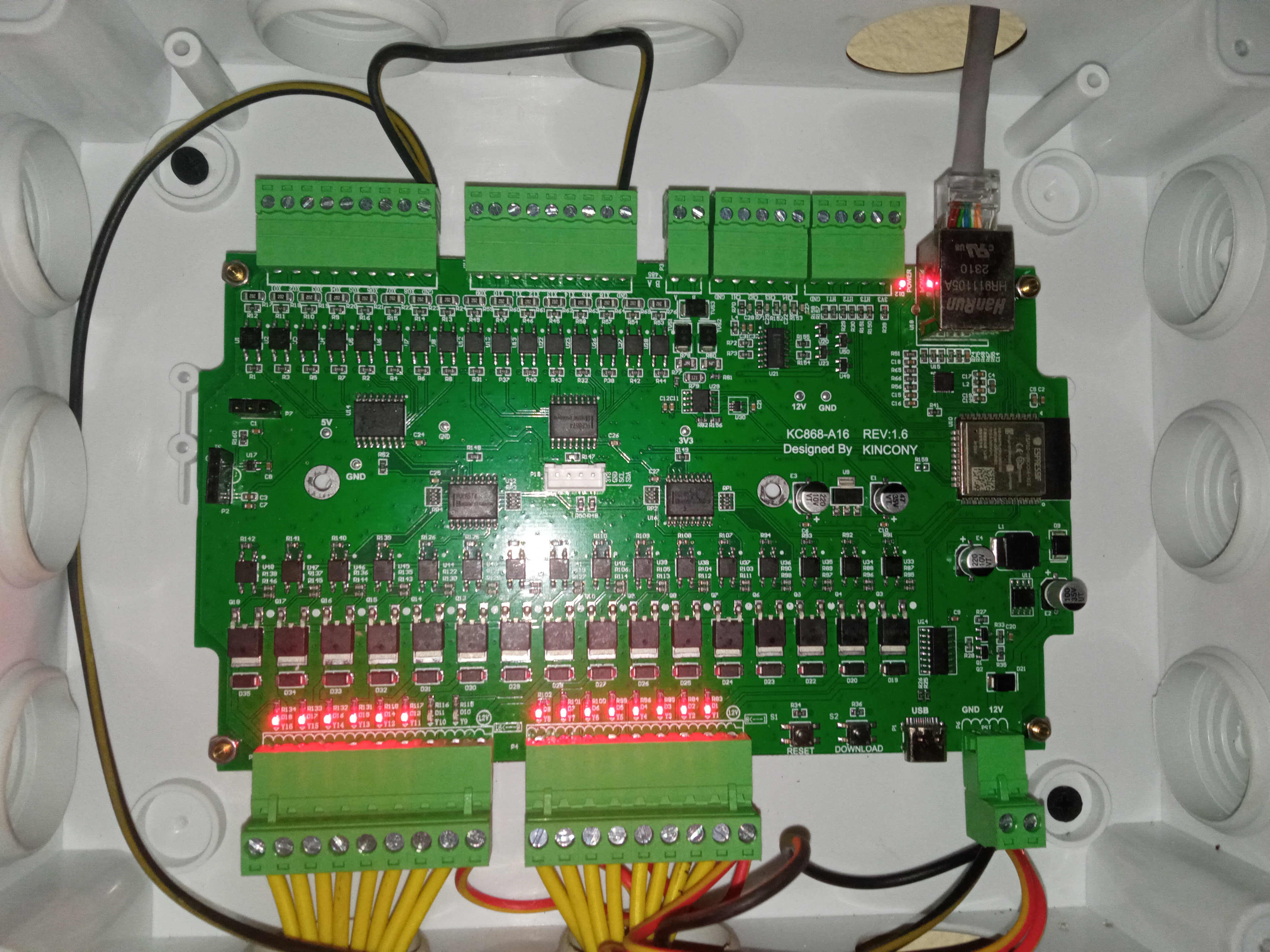

I have uploaded a picture of the board. It seems to be of version 1.6[
attachment=3637][
attachment=3638]
Can you please send me a sample text as for outputs of A16 board using the new I2C address just to be sure if i am using the new I2C addresses correctly.
thank you
old address 21,22,24,25 is correct. make sure your home assistant dashboard have added correct switch button.

i seen your video, all OUTPUT not work well. can you draw a diagram on a paper, how you wire OUTPUT with load, post at here.
attachment=3673]
i did make sure that the wiring for the boards were right. is it some sorts of hardware issue?
when you bought the A16 board, from which store URL?
SORRY! the board is all good. working completely fine. It was the Extend Relay's manual switch which were turned on.

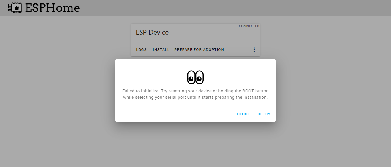

But i am currently facing flashing issue in this A16 board.
I was able to flash this same board earlier once with esphome and next time with Firmware too when you asked to check.
but now when i am trying to flash it back once again with esphome it doesnt seem to be available for flashing. i tried tasmotizer to flash legacy format of esphome into this A16 board but it shows error while flashing.
i also tried the modern format from web.esphome.io where i get error showing "failed to initialize, Please press the boot button".
attachment=3690]
do you have installed RF433M receiver module? if installed, remove it when download firmware.
