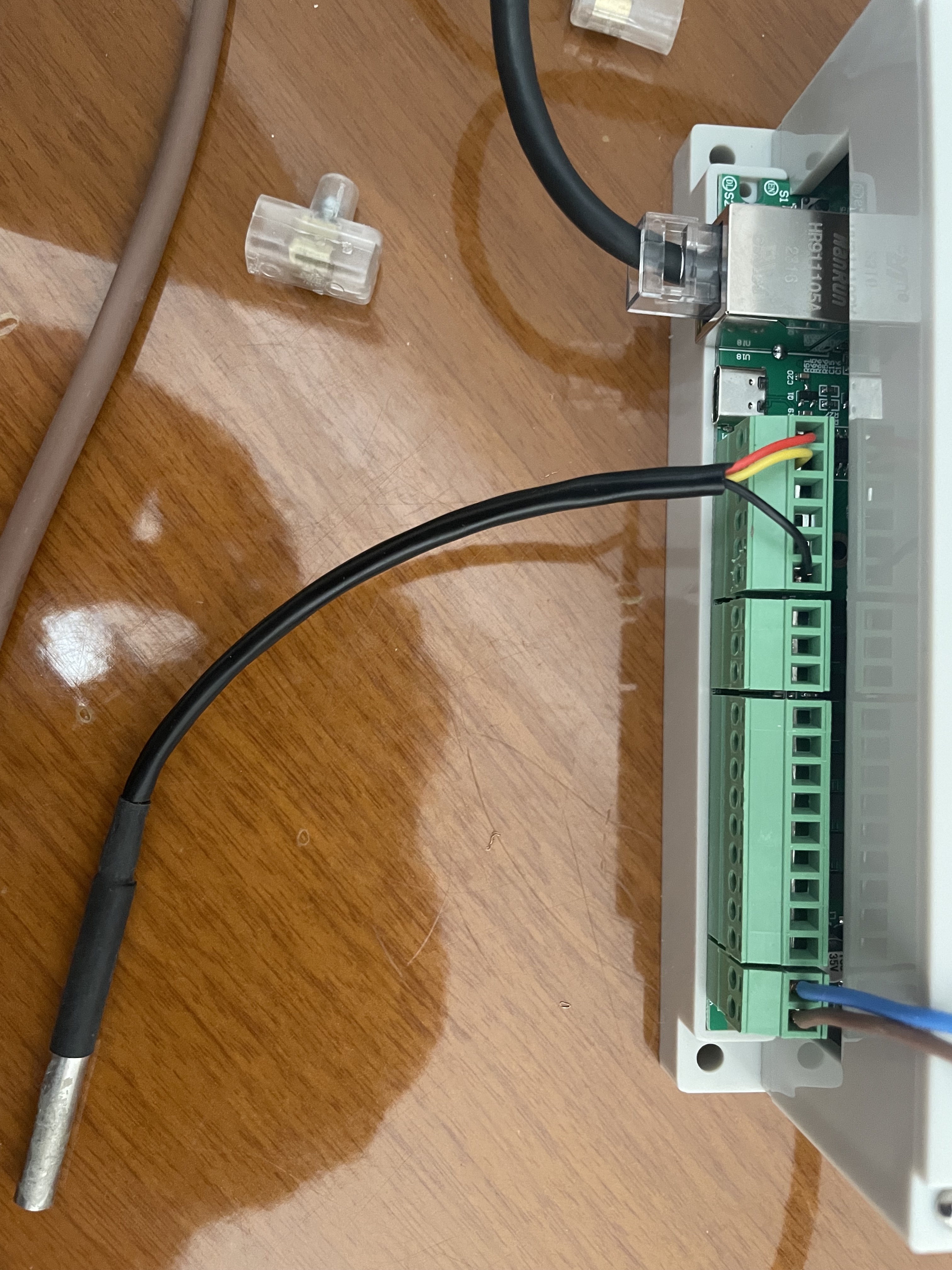

Thank you for your support so far. I was able to see DS18B20 temperature sensor with KCS firmware, but then I loaded ESPhome as I was planning to use 6 sensors in the same wire.
After loading ESPHome I'm not able to see a single sensor anymore ( I have left only one for tests):
Is the following configuration correct for KC868-A16 and onewire sensor detection?
Thanks
Gigi

[23:48:57][E][dallas.sensor:112]: Requesting conversion failedIs the following configuration correct for KC868-A16 and onewire sensor detection?
i2c:
sda: 4
scl: 5
scan: true
dallas:
- pin: GPIO14
- pin: GPIO32
- pin: GPIO33Thanks
