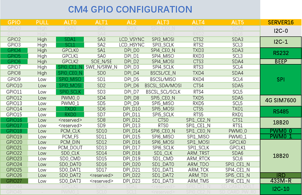

KinCony Server16 Raspberry Pi iot gateway CM4 GPIO pins define
View the full version
with proper formatting.
admin
03-29-2024, 07:33 AM
attachment=4930
