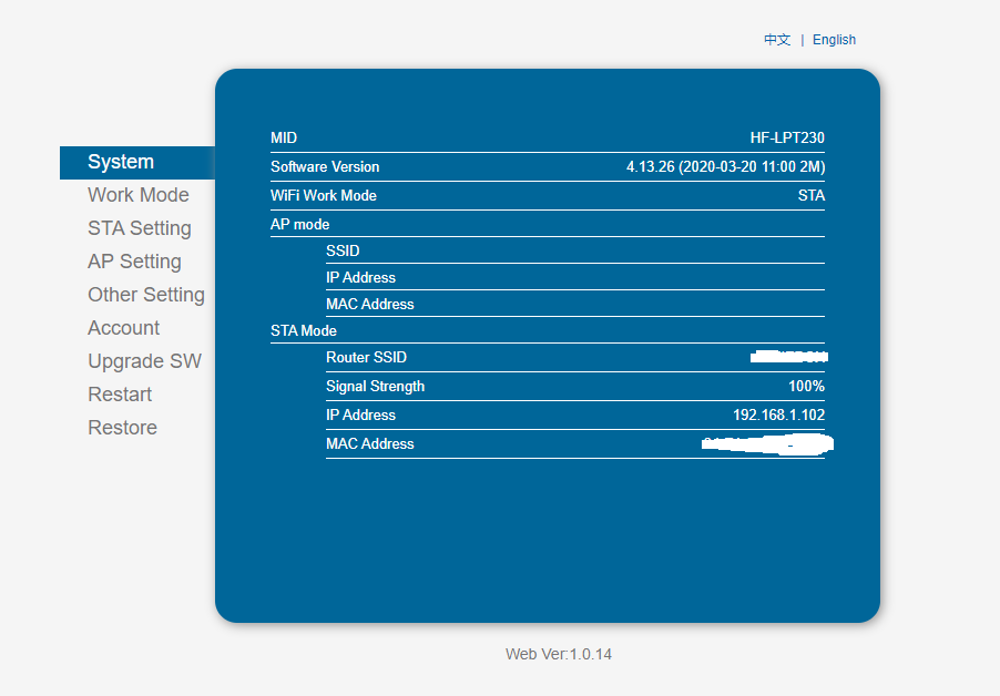

Hi, I have updated to this version, but after reset and restart of the controller the relay Nr. 3 is allways on.
It is on when I unplug it and then replug it, when I save any setting on the web config(after restart) the reley 3 turns on.
I can turn it off with a momentary switch, but after another restart the relay is again on.
