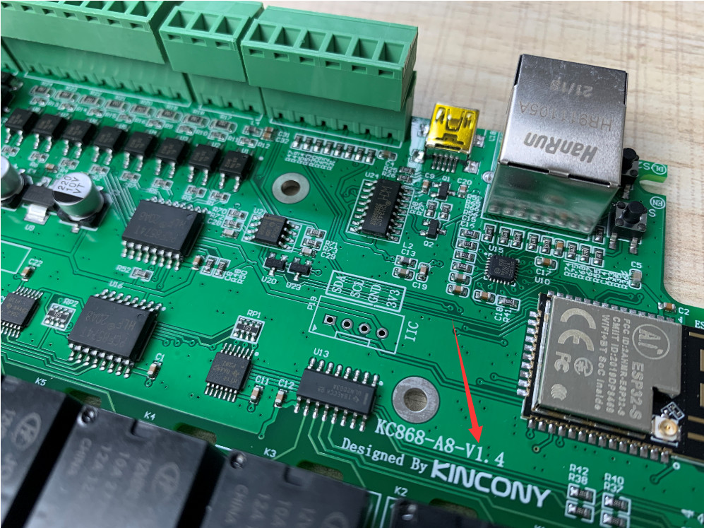

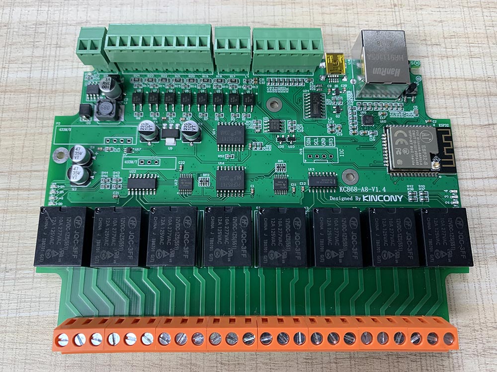

[attachment=352][attachment=353]
#define ANALOG_A1 34 updated in PCB V1.4
