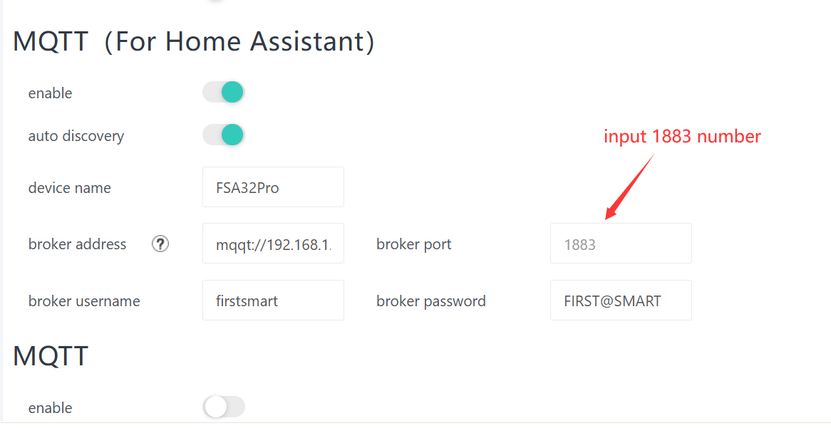

I have flashed the A32 Pro with Kincony firmware and signed in, enabled auto-discovery, but I cannot see the device in Home Assistant. Is there any additional step required to integrate the A32 Pro with Home Assistant?

take your A32Pro setting screen photo.

(07-03-2025, 02:34 AM)admin Wrote: take your A32Pro setting screen photo.
AttachedĀ are the screenshots
RE: A32 Pro - admin - 07-03-2025
please input the port 1883, the color is grey, so it not used.
RE: A32 Pro - fdcemb5 - 07-03-2025
I have inserted the port number, but I am unable to see A32 Pro in HA. How does the auto-recovery work
RE: A32 Pro - admin - 07-04-2025
you have input mqqt://192.168.x.x
you should input mqtt://192.168.x.x
it's "mqtt", not "mqqqt", please see carefully.

I have done all the above, but can still not see A32 Pro HA. I have also cleared the Cache. Is there any other thing I can do, or can I discover it mannually?

I have sorted it out, and A32 Pro is now discoverable at MQTT entries
