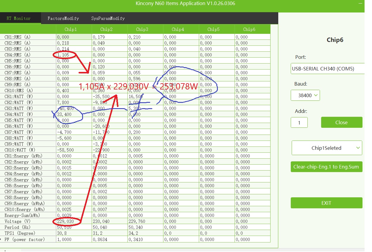

However, since then the power readings seem to be all wrong. For example, channel 1.4 should be about 300W rather then 36W

I used the new version of the app, pressed the clear button and after that, turned off power for 30sec and on again but still wrong power.
do you means old ARM CPU firmware is correct, just after updated newest ARM CPU, value is error?
Yes, the default firmware it shipped with gave me a correct power reading.
I updated to  N102030_KU_V20_260305SP.bin first (by mistake earlier version). Today to N10203060_KU_V20_260324SP.bin.

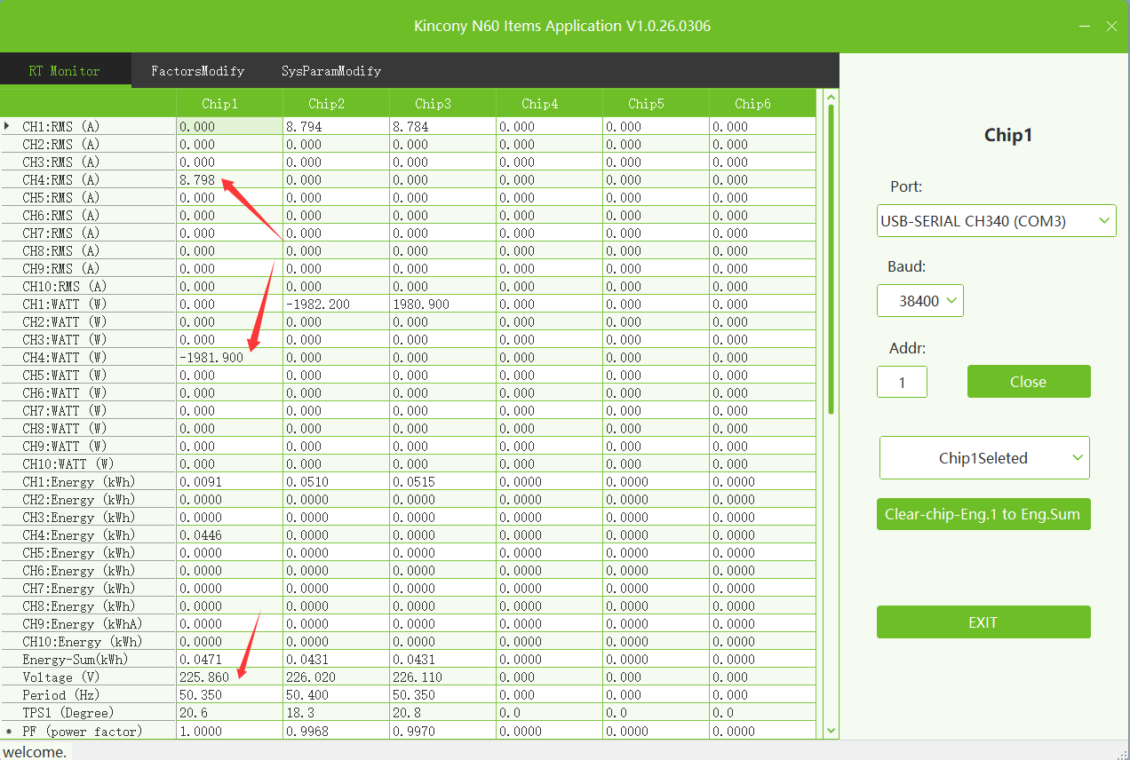

I pressed clear chip button and rebooted, but power reading remains wrong as seen in screenshot

Once again I cleared chip 1-3 and pressed the reset button for >3 seconds. The connection is then lost to the Kincony items application and I have to reconnect.
However once again the wattages are incorrect. I've never changed the coeficient, but as you can seen in the screenshot it is at one
