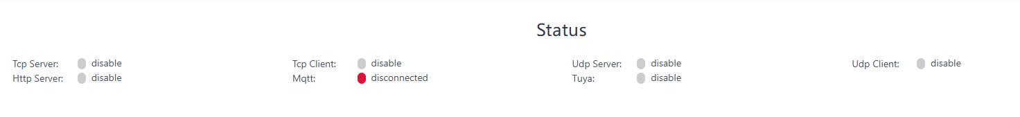

Hello again, thank you for your help.
I flashed the device using my main PC and managed to connect to the wifi using a different PC and could connect to the 192.168.4.1.

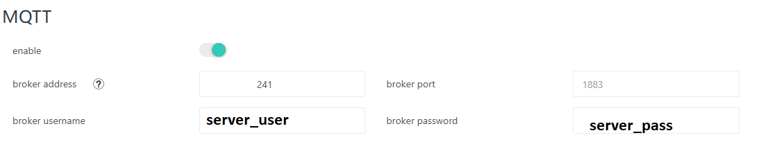

Now my problem is figuring out the MQTT connection. I used an open and working MQTT server/connection that I can see is currently working. It doesn't use any certificates or the like. The A6 doesn't seem to be able to connect after specifying the broker address, port, username and password.
EDIT: OK, I missed that you need to add mqtt:// or mqtts:// in the broker address field.
Is there a list of topics or parameters that are configured in the device or are topics only based on SET and STATUS?
Additionally: All the configurations done on the internal web of the kincony device are overwritten once it is flashed using ESPHome or not necessarily?
Thank you for your time.
