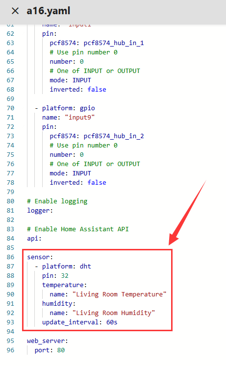

how to use DHT22 temperature humidity sensor with KC868-A16 by ESPHome
DHT22 use by 3.5v--5.5v power. so i have contact with 433MHz receiver's pin, that have a 5V point.

sensor:
  - platform: dht
    pin: 32
    temperature:
    humidity:
      name: "Living Room Humidity"
    update_interval: 60s
