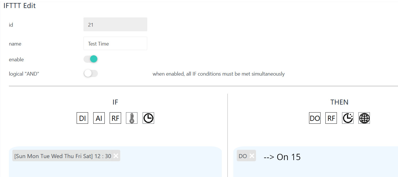

I set up an A16 device with the software version v.2.2.12. The display of the time on index page is still not correct. It should always follow the format YYYY-MM-DD HH:MI:SS.
Unfortunatlely the date & time is displayed like this: "2025-02.27 7:5:27" Please see attached image.
In addition to that, the IFTTT time function is not working. When time is reached, the configured output is not switched on.
What am I doing wrong?
