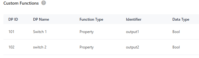

(11-06-2025, 12:13 PM)admin Wrote: relay-1: DP ID: 103
relay-2: DP ID: 104
No, this not right. I checked. Not works.
Then i go to log on tuya side and found that ESP report not by ID number, it report by ID name (identifier). ESP send ID "output1" and "output2".
So, i changed identifier names to "output1" and "output2" and it start works. ID number - doesn't matter.
