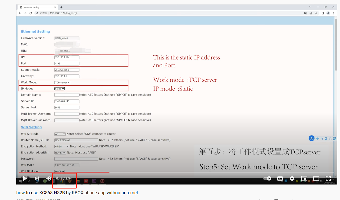

https://www.youtube.com/watch?v=Yn0yTdkN_Kw
Follow the instructions in this video. it will tell you how to scan the ethernet IP address and go to the web page to set parameters.
The principle is simple: Connect the network cable, open the scanning software, search for device IP addresses in the same LAN, copy the IP addresses, and open the web page to enter the setting page
if you want to use KBOX,the the WorkMode to tcp server and the ip mode set to static(can't conflict),alse you can set wifi to TCP server mode ,then the port maybe is 5555 not 4196,and the iP mode alse set to static
if you want to use smart home app via ethernet ,then set ethernet work mode to UDP,and ip mode to DHCP, and use KBOX via WIFI,then set wifi work mode to TCP server
if you want to use KBOX via MQTT,then set the ethernet work mode to MQTT,input the server iP an port.
