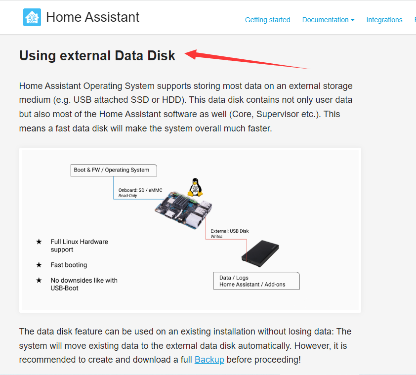

2. here is home assistant said about it in this URL:  https://www.home-assistant.io/common-tasks/os/
see photo,
because official not said the details MAX size, so i can't see it. But supported the size is already enough for people to use. i use 128G usb disk.
CM4 have USB2.0, the speed enough to use.

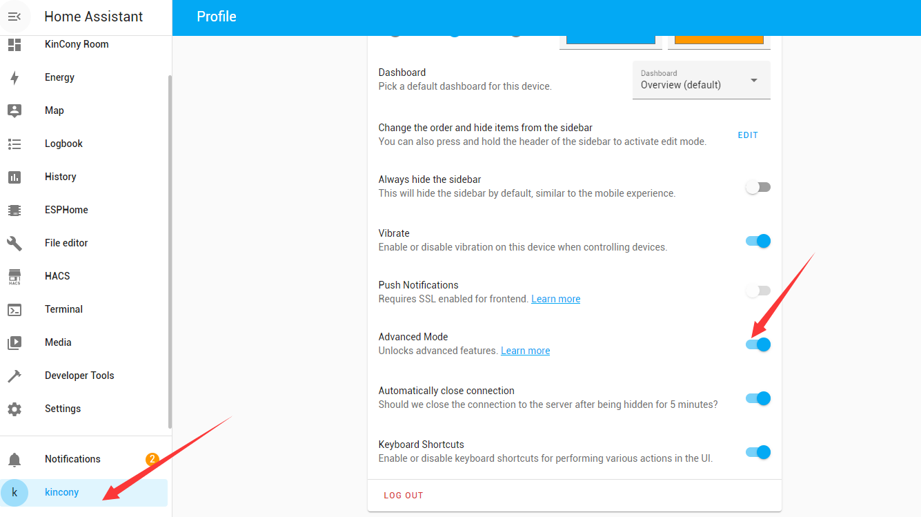

5. if you can't see "move datadisk", please enable "avdantage mode " in your home assistant setting.
if integrate KC868-A16 with home assistant by esphome, not need use by MQTT.
