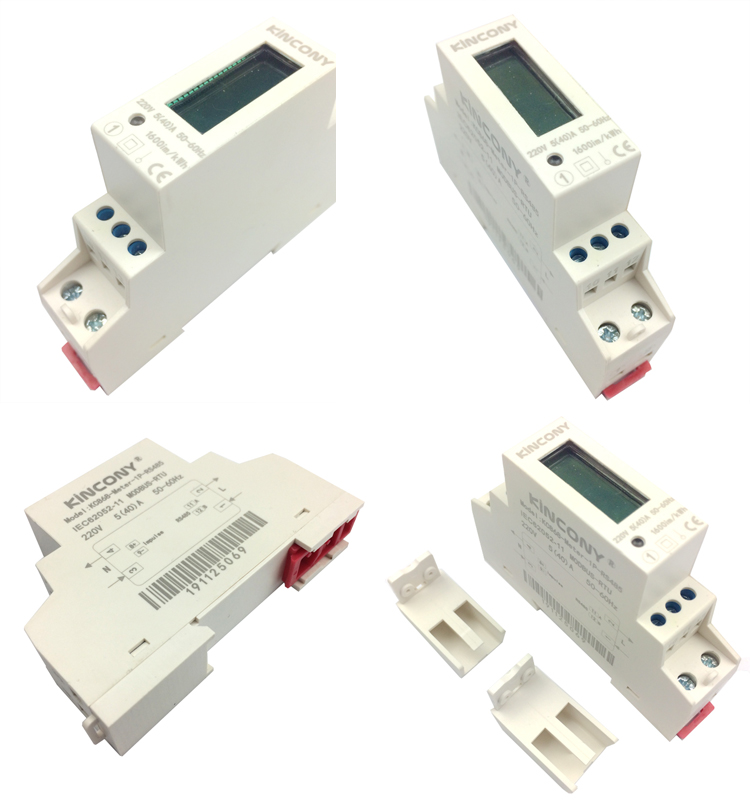

KinCony RS485 energy meter RS485 modbus protocol
Modbus-RTU: 9600 E 8 1  read function:03
Register address        data                                        data type-IEEE-754      function
0000, 0001              power consumption (kWh)                 Float                        read
0100, 0101                  voltage (V)                                   Float                        read
0106, 0107                  current  (A)                                  Float                        read
0118, 0119                  power (kW)                                  Float                        read
0142, 0143                  power factor                                 Float                        read
0144, 0145                  frequency                                     Float                        read
How to change meter ID, for example: change ID:01  to 20 just send command:
01 10 0D B0 00 01 02 00 14 60 AF
first (01) current ID
14 is (20) decimal
60 AF (CRC)
