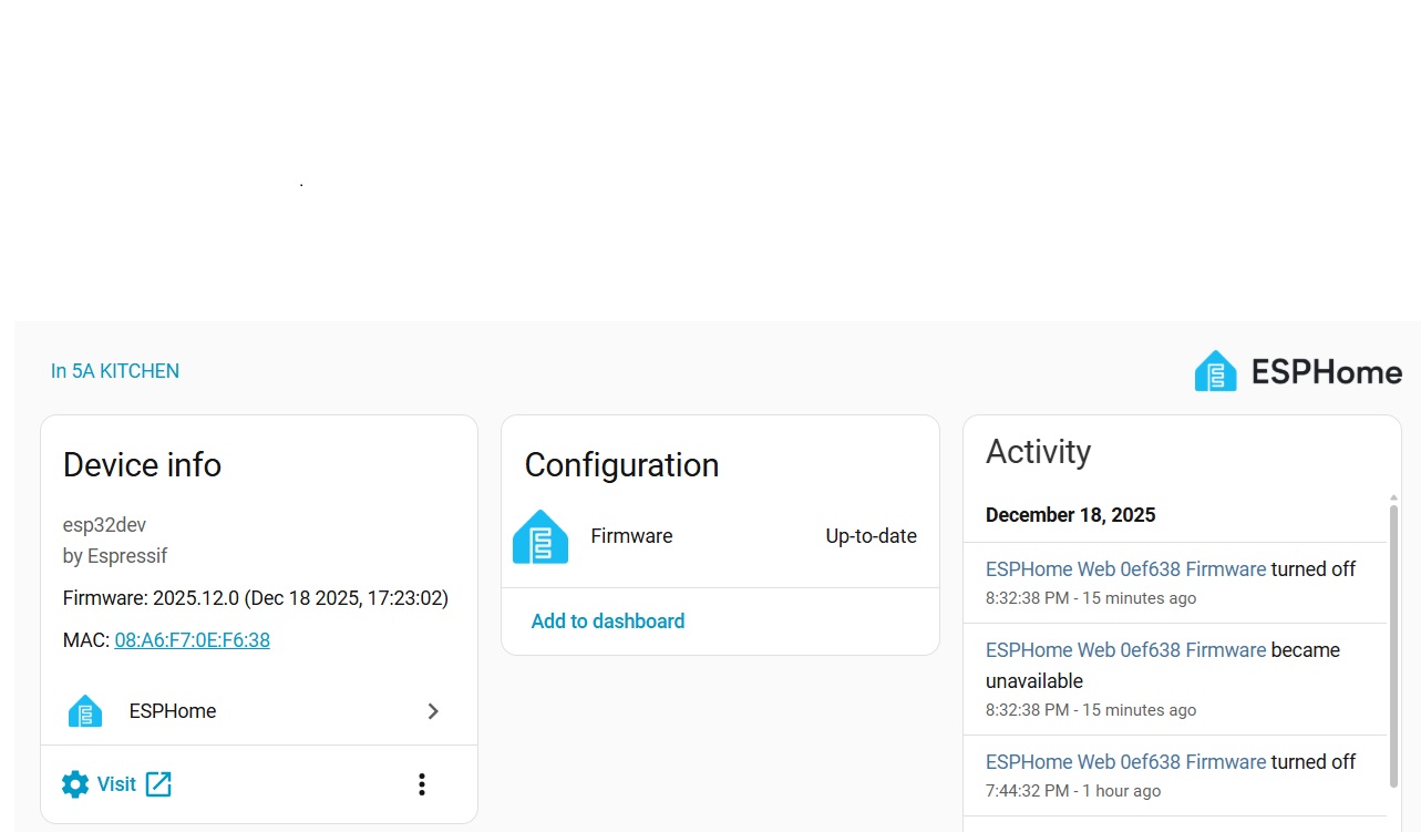

hi
i bought a m16v2.1 and loaded into HA via esphome. however the input sensors dont show. i only see the firmware sensor as in the image. where might the issue be.

hi,
managed to get M16v2 integrated into HA via esphome. the route I followed was to do the initial setup in esphome, and then selected the install option. all went ok. the device was then discoverable by HA. When i look at it in HA it doesn't have the input sensors. see attached image. what is missing?

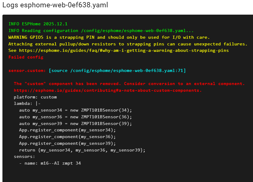

used to yaml file but am getting a custom error in esphome builder.
use this yaml: https://www.kincony.com/forum/attachment.php?aid=8221
(12-21-2025, 01:35 PM)admin Wrote: use this yaml: https://www.kincony.com/forum/attachment.php?aid=8221
Still no good. I get an error about an issue with the github link not finding the init file.
external_components: [source /config/esphome/powermeter.yaml:10] - source: type: git url: https://github.com/hzkincony/esphome-zmpt101b components:  Could not find __init__.py file for component ZMPT101B. Please check the component is defined by this source (search path: /data/external_components/11fcc513/components/ZMPT101B/__init__.py).
Used this code to define the component but it still fails too:

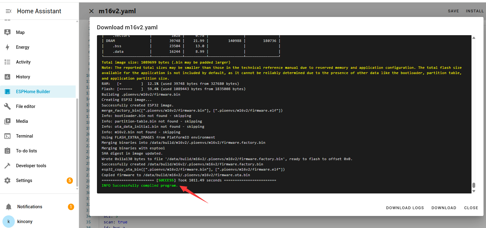

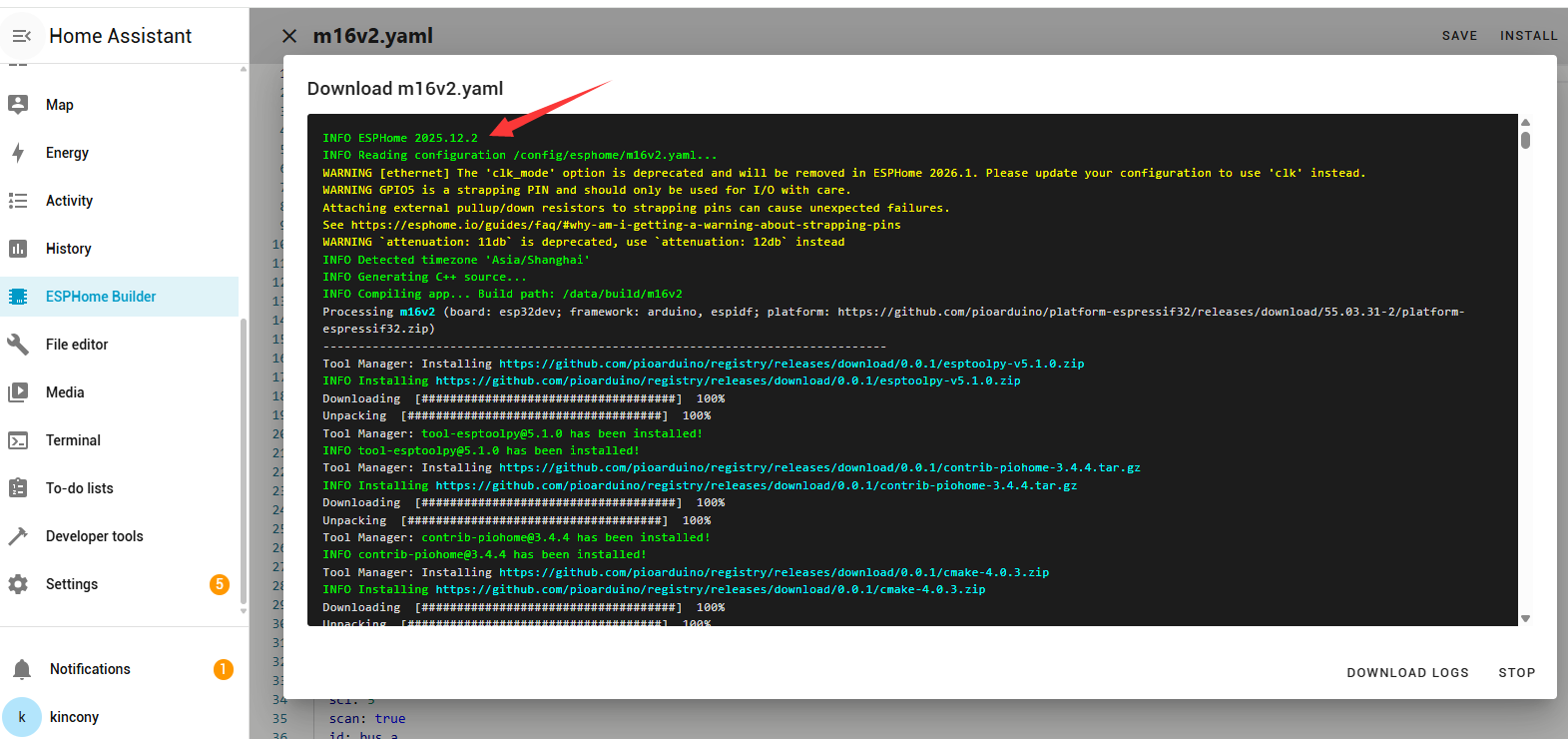

we have updated plugin file for esphome today. you just re compile esphome yaml file will be ok.

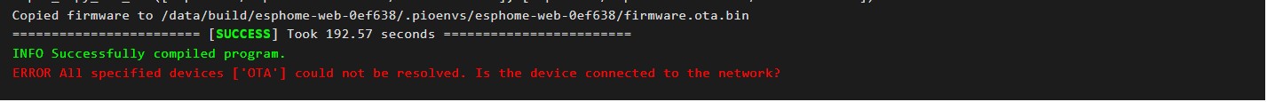

i get this error when i install via esphome builder from within HA.
INFO ESPHome 2025.12.1
INFO Reading configuration /config/esphome/esphome-web-0ef638.yaml...
Failed config
external_components: [source /config/esphome/esphome-web-0ef638.yaml:17]
  - source:
      type: git
    components:
      - ZMPT101B
    refresh: 1min
.txt   esphome.txt (Size: 9.57 KB / Downloads: 287)

tested with newest esphome:
success. thanks. Smile
