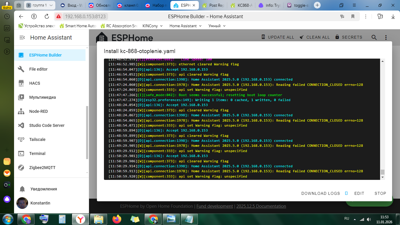

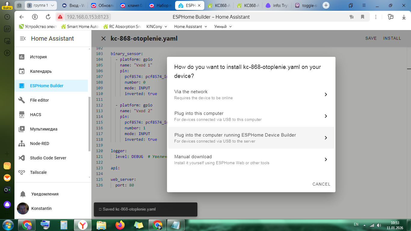

Привет! Не получается подключить к Home Assistant. Что я делаю не так?
Hi! I can't connect to the Home Assistant. What am I doing wrong?
.txt   logs_kc-868-otoplenie_run.txt (Size: 173.62 KB / Downloads: 355)
.txt   дописал 8 выходов.txt (Size: 2.19 KB / Downloads: 292)

(01-11-2026, 11:18 AM)admin Wrote: if you use our yaml file directly, whether work well?
when using your original YAML file, it also doesn't work.

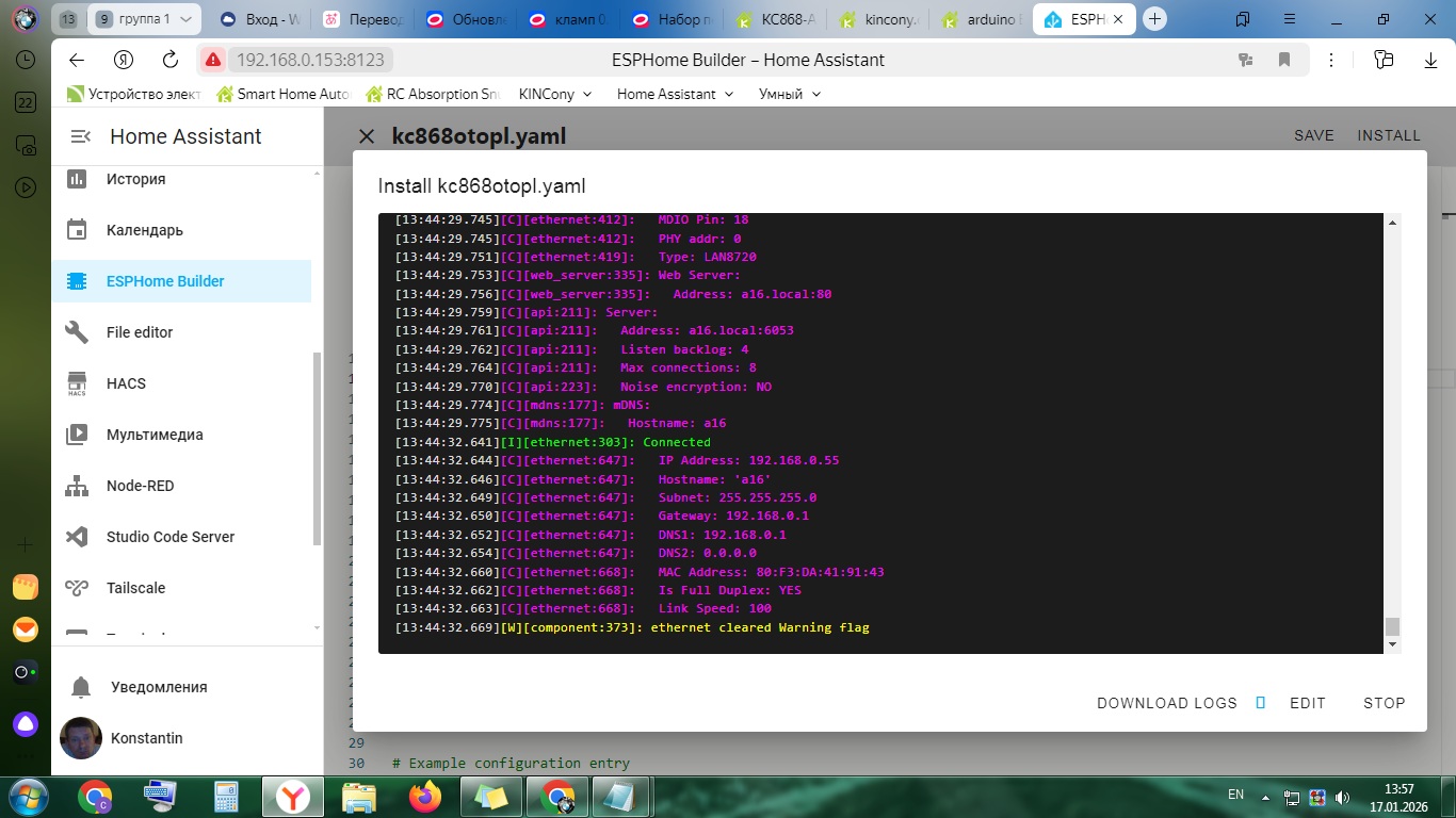

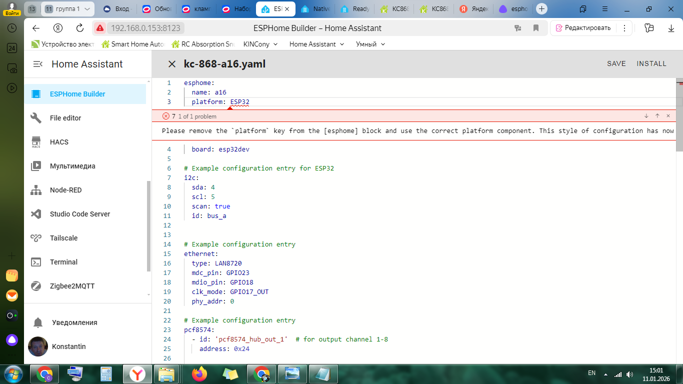

I changed the beginning of the yaml file, there was this error
.txt   logs_kc-868-a16_run.txt (Size: 89.6 KB / Downloads: 387)

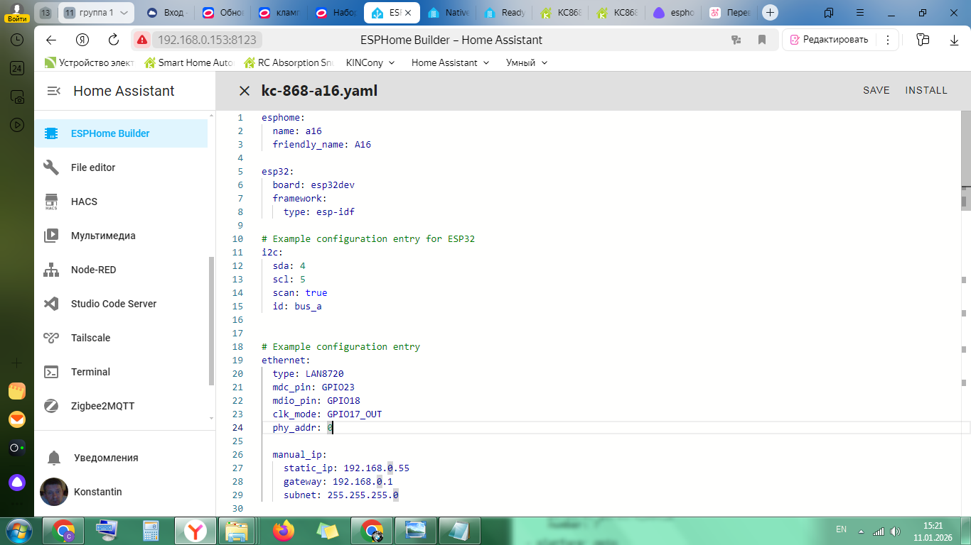

Hi! I used the updated yaml file. Mistake!
.txt   logs_kc868otopl_run (1).txt (Size: 154.72 KB / Downloads: 363)

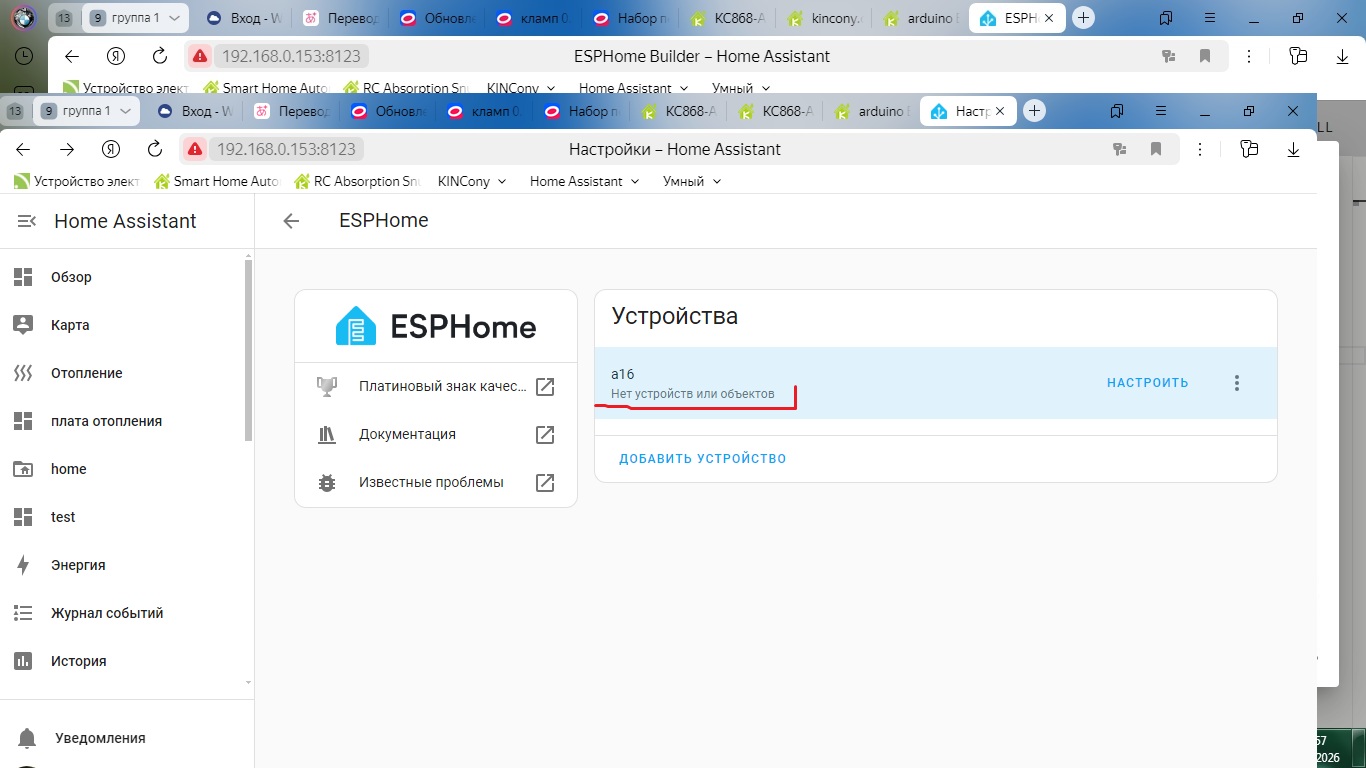

(01-17-2026, 12:03 PM)admin Wrote: where have problem? it already compile finished.
there are no devices or objects

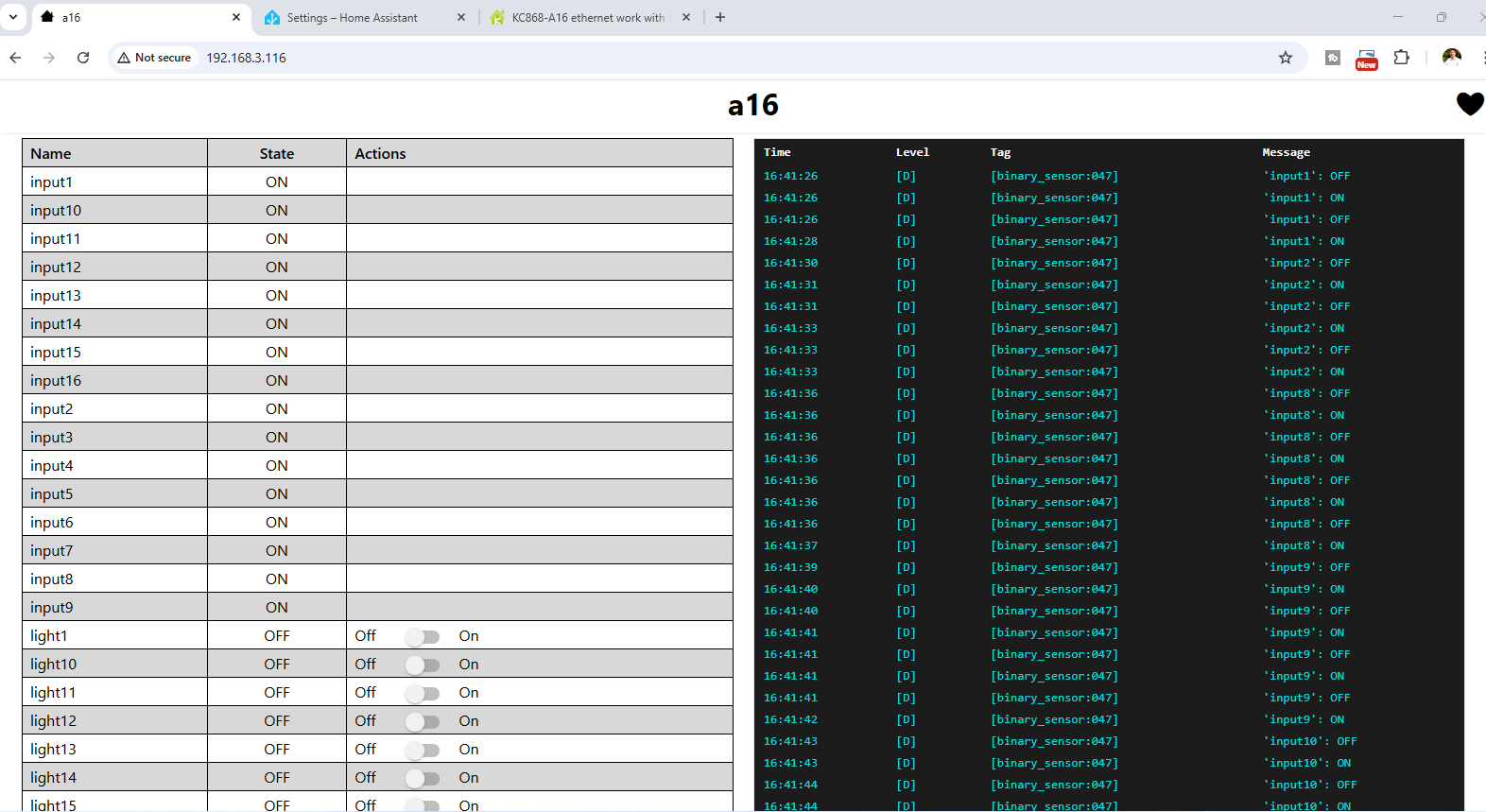

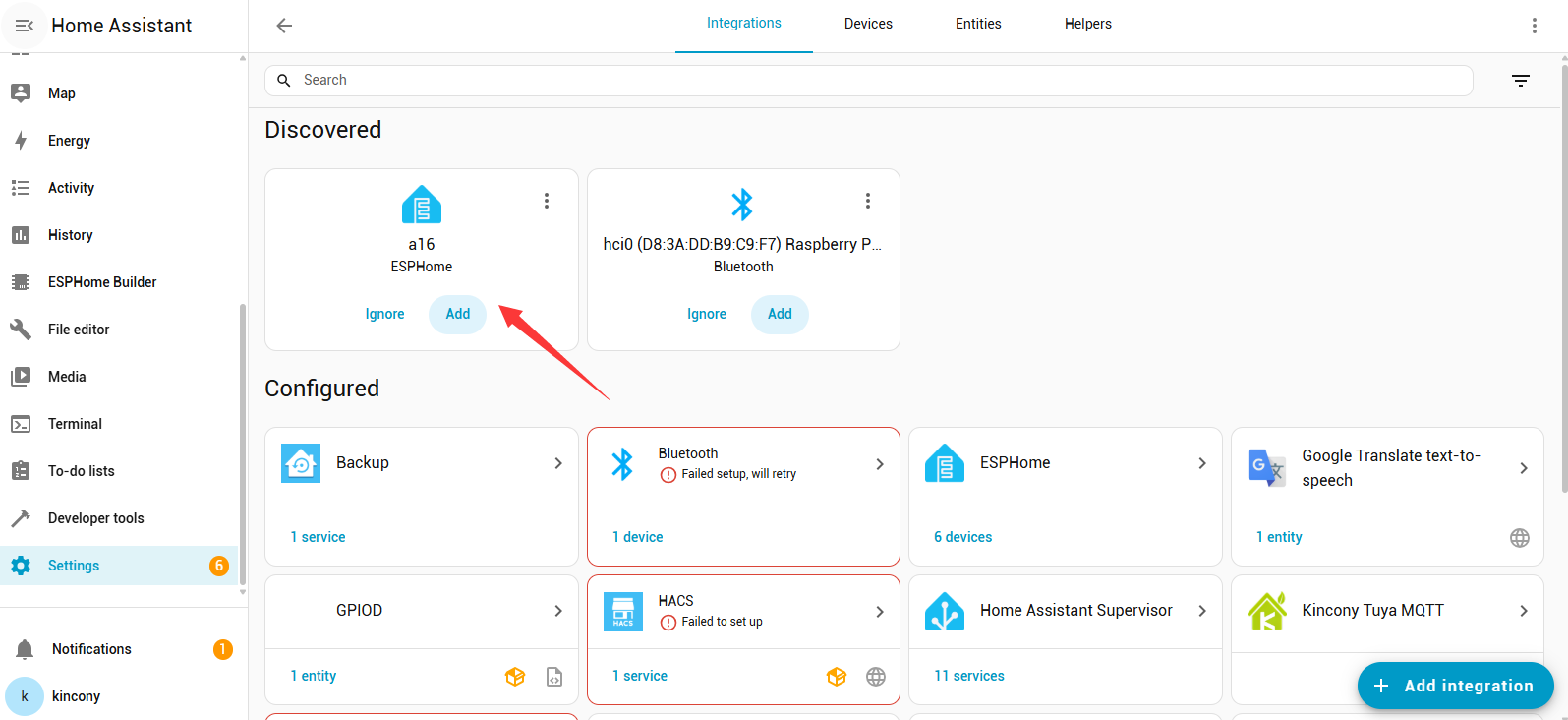

tested with this new yaml, it can work directly.
  friendly_name: a16
esp32:
  board: esp32dev
  framework:
    type: arduino
i2c:
  sda: 4
  scl: 5
  scan: true
# Example configuration entry
ethernet:
  type: LAN8720
  mdc_pin: GPIO23
  mdio_pin: GPIO18
  clk:
    pin: GPIO17
    mode: CLK_OUT
  phy_addr: 0
pcf8574:
    address: 0x24
    address: 0x25
    address: 0x21
    address: 0x22
# Individual outputs
  - platform: gpio
    pin:
      pcf8574: pcf8574_hub_out_1
      number: 0
      mode: OUTPUT
      inverted: false
  - platform: gpio
    pin:
      number: 1
      mode: OUTPUT
      inverted: false
  - platform: gpio
    pin:
      number: 2
      mode: OUTPUT
      inverted: false
  - platform: gpio
    pin:
      number: 3
      mode: OUTPUT
      inverted: false
  - platform: gpio
    pin:
      number: 4
      mode: OUTPUT
      inverted: false
  - platform: gpio
    pin:
      number: 5
      mode: OUTPUT
      inverted: false
  - platform: gpio
    pin:
      number: 6
      mode: OUTPUT
      inverted: false
  - platform: gpio
    pin:
      number: 7
      mode: OUTPUT
      inverted: false
  - platform: gpio
    pin:
      pcf8574: pcf8574_hub_out_2
      number: 0
      mode: OUTPUT
      inverted: false
  - platform: gpio
    pin:
      number: 1
      mode: OUTPUT
      inverted: false
  - platform: gpio
    pin:
      number: 2
      mode: OUTPUT
      inverted: false
  - platform: gpio
    pin:
      number: 3
      mode: OUTPUT
      inverted: false
  - platform: gpio
    pin:
      number: 4
      mode: OUTPUT
      inverted: false
  - platform: gpio
    pin:
      number: 5
      mode: OUTPUT
      inverted: false
  - platform: gpio
    pin:
      number: 6
      mode: OUTPUT
      inverted: false
  - platform: gpio
    pin:
      number: 7
      mode: OUTPUT
      inverted: false
binary_sensor:
  - platform: gpio
    pin:
      pcf8574: pcf8574_hub_in_2
      number: 0
      mode: INPUT
      inverted: true
  - platform: gpio
    pin:
      number: 1
      mode: INPUT
      inverted: true
  - platform: gpio
    pin:
      number: 2
      mode: INPUT
      inverted: true
  - platform: gpio
    pin:
      number: 3
      mode: INPUT
      inverted: true
  - platform: gpio
    pin:
      number: 4
      mode: INPUT
      inverted: true
  - platform: gpio
    pin:
      number: 5
      mode: INPUT
      inverted: true
  - platform: gpio
    pin:
      number: 6
      mode: INPUT
      inverted: true
  - platform: gpio
    pin:
      number: 7
      mode: INPUT
      inverted: true
  - platform: gpio
    pin:
      pcf8574: pcf8574_hub_in_1
      number: 0
      mode: INPUT
      inverted: true
  - platform: gpio
    pin:
      number: 1
      mode: INPUT
      inverted: true
  - platform: gpio
    pin:
      number: 2
      mode: INPUT
      inverted: true
  - platform: gpio
    pin:
      number: 3
      mode: INPUT
      inverted: true
  - platform: gpio
    pin:
      number: 4
      mode: INPUT
      inverted: true
  - platform: gpio
    pin:
      number: 5
      mode: INPUT
      inverted: true
  - platform: gpio
    pin:
      number: 6
      mode: INPUT
      inverted: true
  - platform: gpio
    pin:
      number: 7
      mode: INPUT
      inverted: true
# Enable Home Assistant API
web_server:
  port: 80
yaml file:
.txt   ESPHome_A16.txt (Size: 5.37 KB / Downloads: 454)
