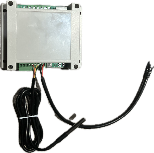

I share an update in yaml file to add temperature sensor management (type Dallas DS18B20) with KC868-A2.
The yaml file is the following
The photo below shows a DS18B20 sensor connected on the KC868-A2 board
