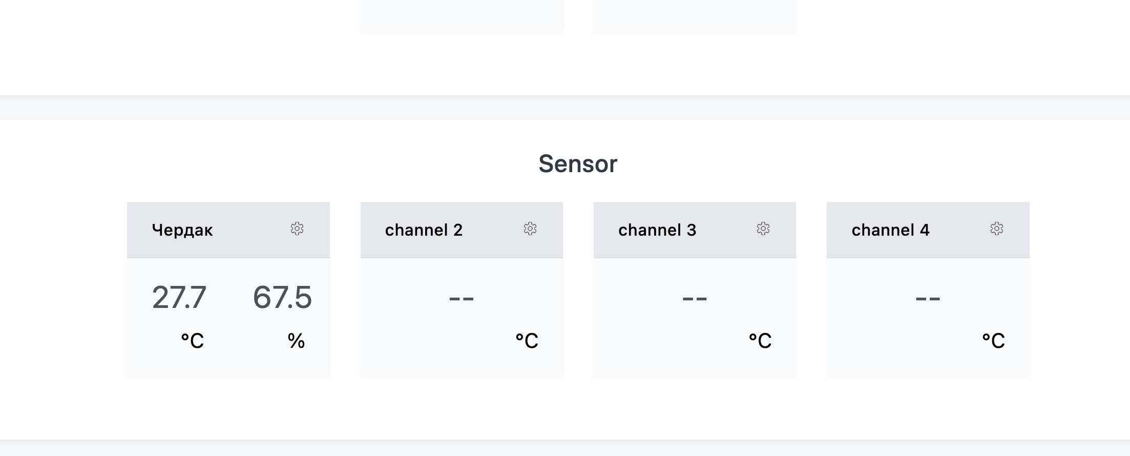

(08-03-2025, 12:07 AM)admin Wrote: support use by DS18B20, DHT11, DHT22 sensor. these sensor will work with KCS firmware and show in home assistant by MQTT integration.
I installed a DHT22 sensor.
How can I forward it to Home Assistant via MQTT?

(08-06-2025, 01:57 PM)admin Wrote: check mqtt prototol at here: https://www.kincony.com/forum/attachment.php?aid=2872
Thank you, the sensors have been added, but the values are not updated. Tell me how to force the values to update.

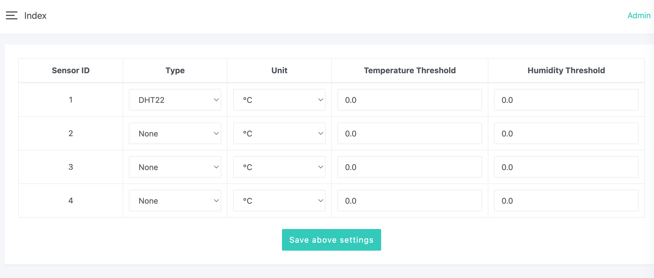

#25
for example, in your KCS sensor webpage, you need set the "threshold" for temperature and humidity.
temperature=0.1
humidity=1
#26
(08-06-2025, 11:58 PM)admin Wrote: for example, in your KCS sensor webpage, you need set the "threshold" for temperature and humidity.
temperature=0.1
humidity=1

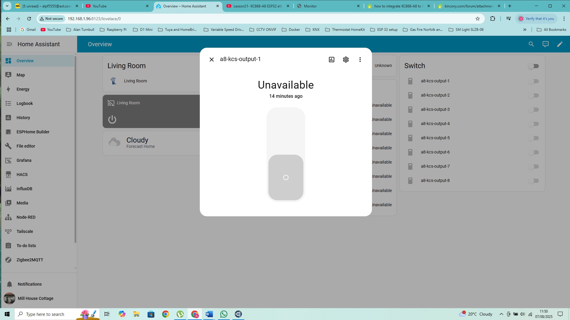

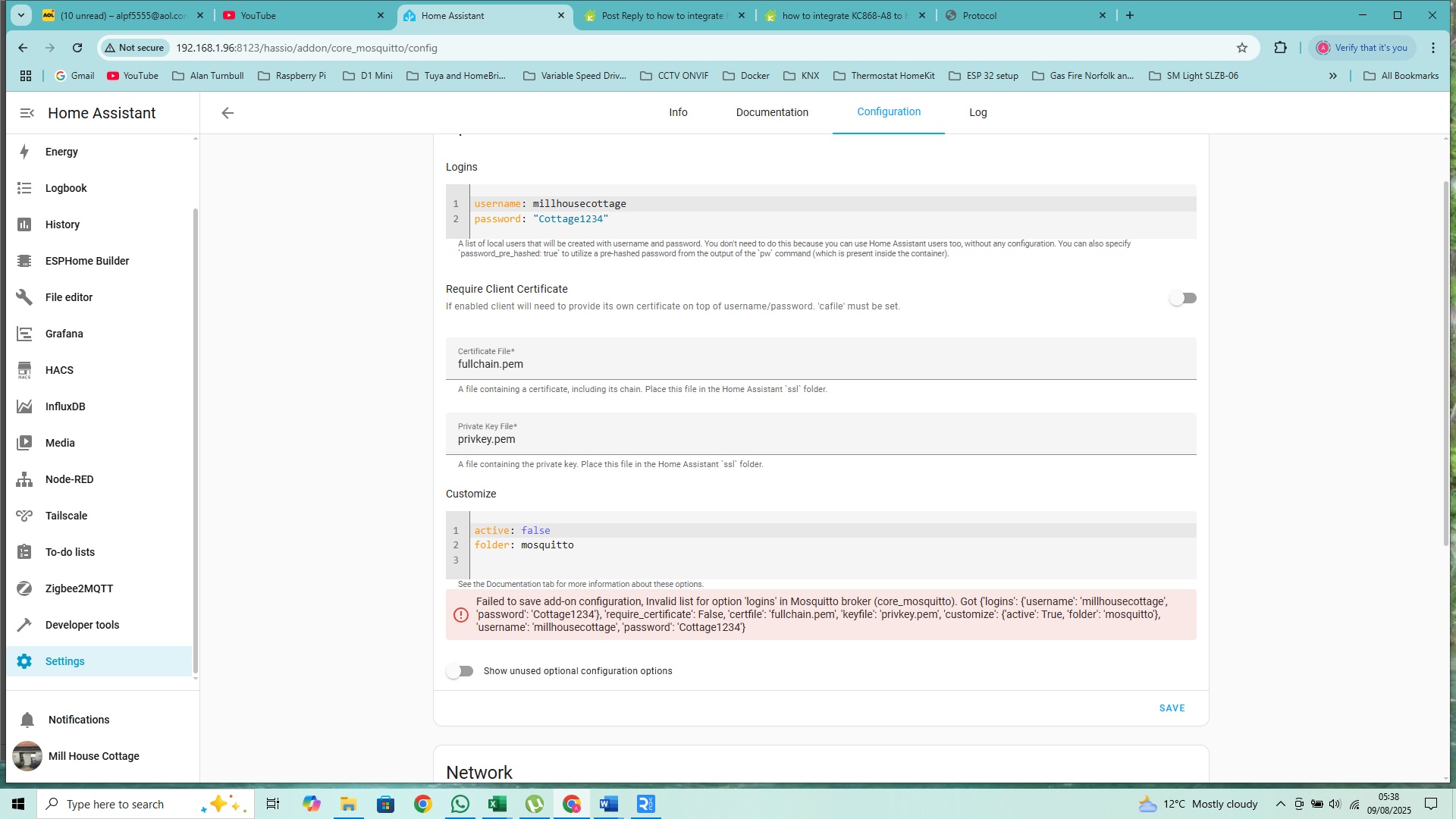

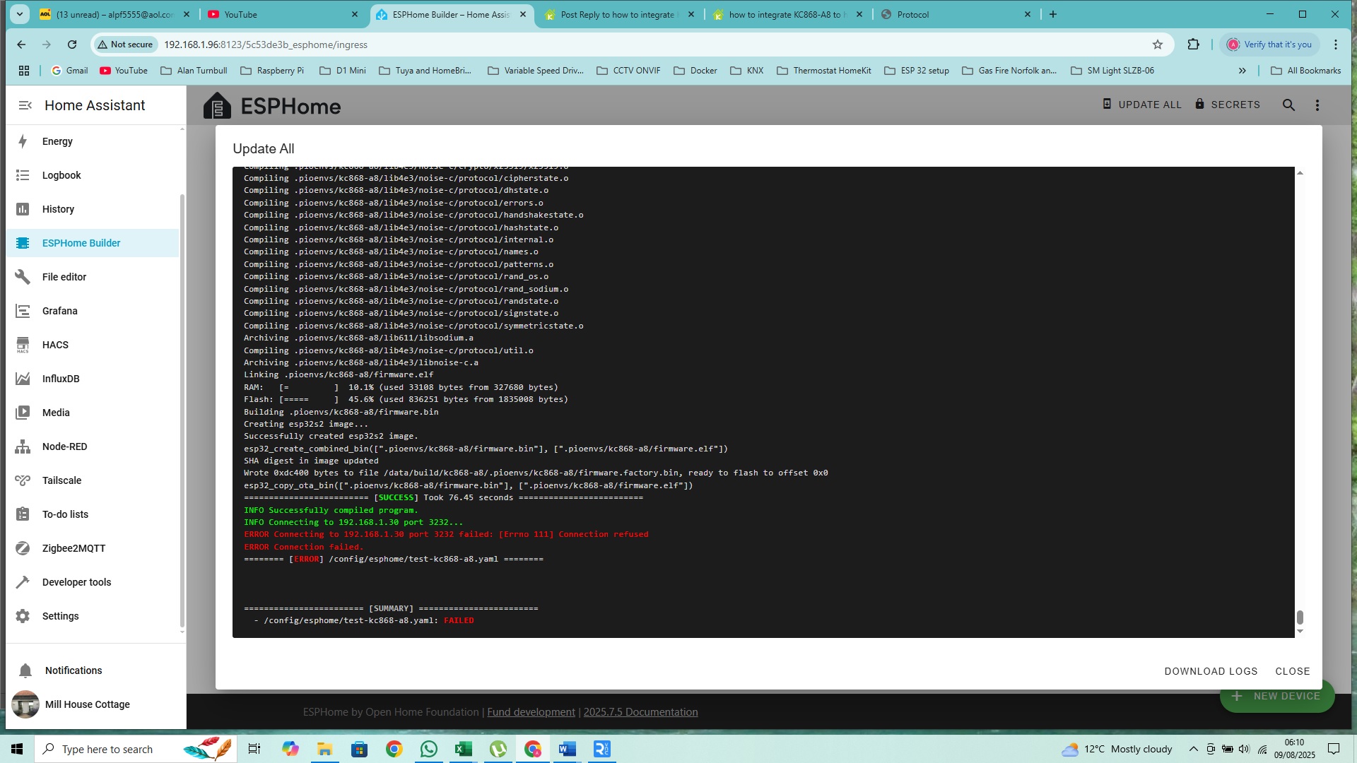

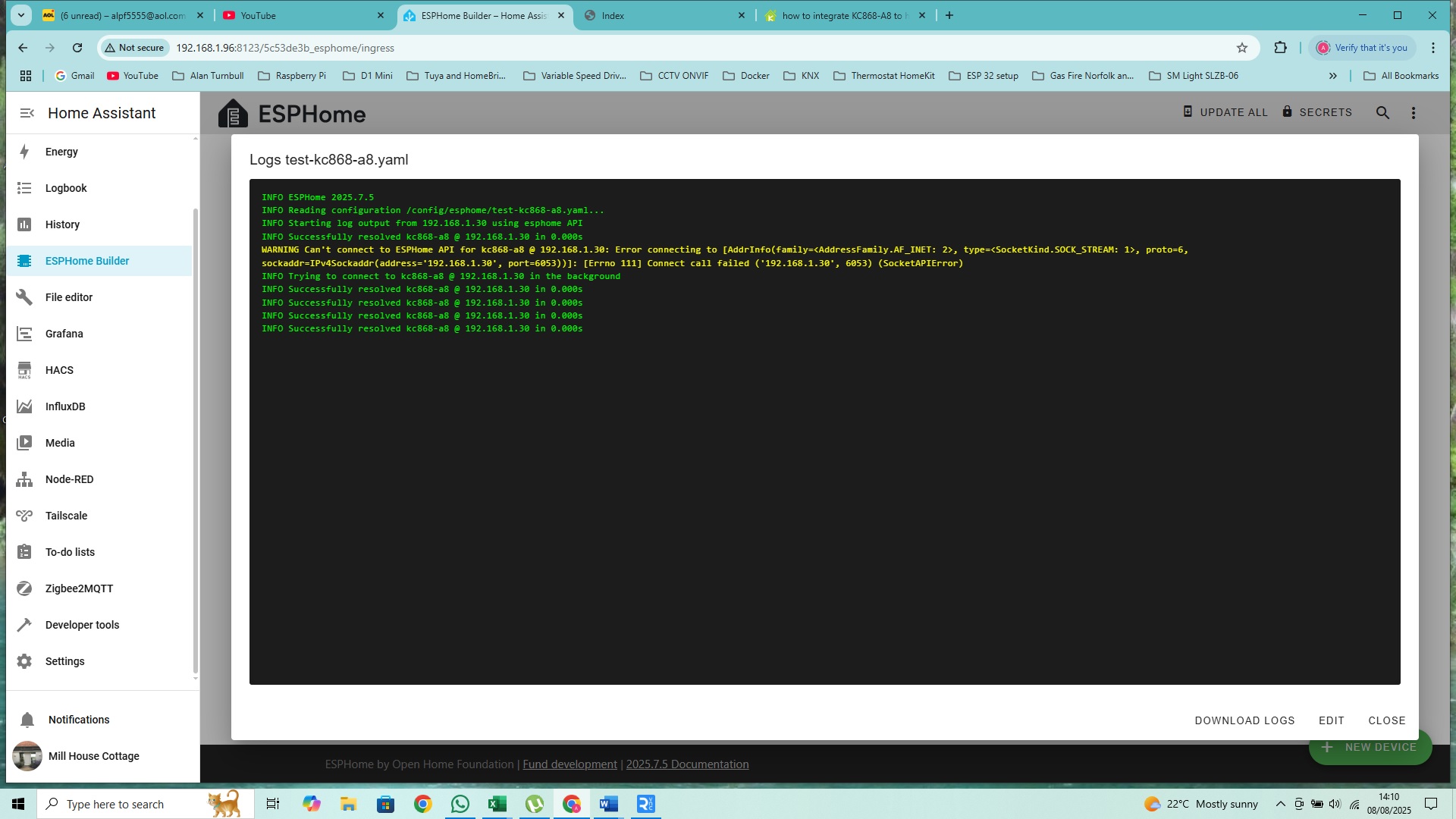

Dear sir
     I have followed your instructions on setting up a KC868-A8 in Home Assistant and have got on the overview the 8 inputs and 8 outputs but they are unavailable and have been every time I have made changes
I have deleted the device a number of times and rein stalled it with different firmware but every time it is the same result.
I am thinking that it is not connected to MQTT in Home Assistant but I can see it connected to MQTT on the Kinconny web page and can operate the relays and see a temperature probe I have installed I can see the inputs operate and in Node Red on Home Assistant I can read the inputs and outputs.

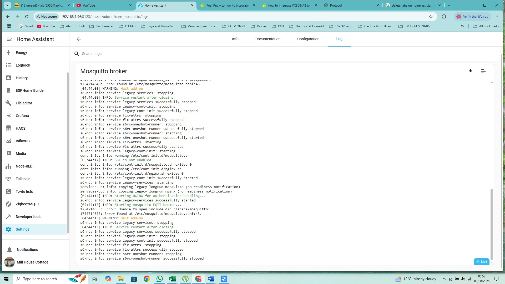

The one part I am having a real problem with is the MQTT part in HA I have tried to add a user in the logins as per your instructions but get an error message when I try to change the file. See attached file below.  The files are in the folder where I attach files to
 I have also downloaded the log file from the A8 and it shows a warning message see below

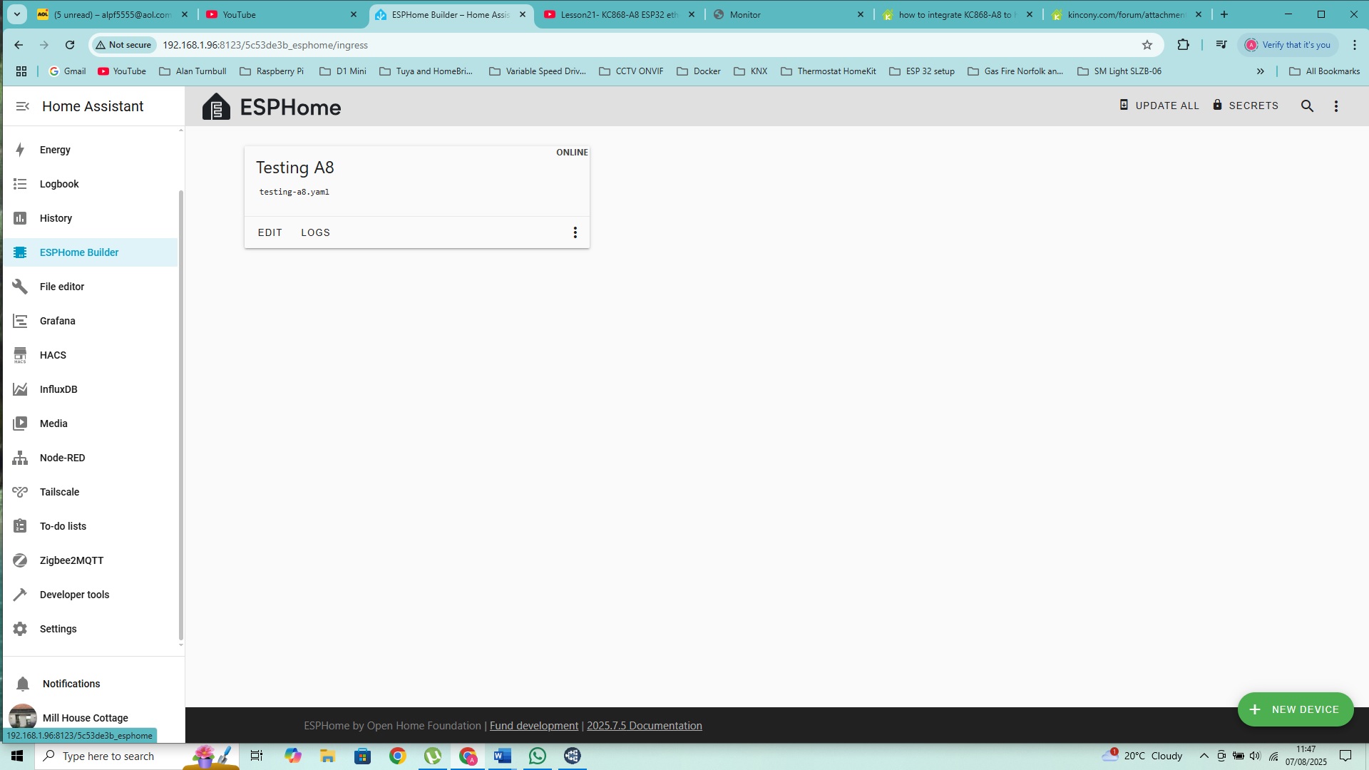

 I have tried I think everything except the right thing but I do not know what that is I am hoping that you will be able to help me I have also attached a screen shot of the Esp Home Page below
Yours
Alan Turnbull

#29
do you want to use esphome? if YES, just use by yaml file, not need to use mqtt.
esphome yaml file: https://www.kincony.com/forum/showthread.php?tid=2367
note: esphome and KCS firmware , can't work at the same time.

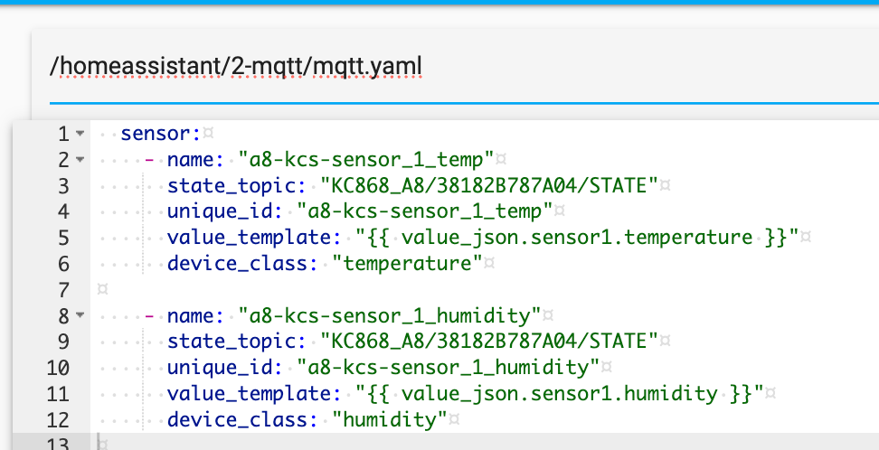

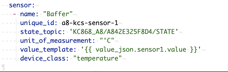

 I recently integrated all inputs and outputs to HA, unfortunately I stuck with temperature sensors.
I'm using DS18B20 and I see the values while listening in MQTT, but from some reason I cannot read the value on dashboard, I`m more than sure that something is wrong in my config.

And this is my config for sensor1:
