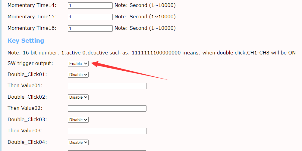

#50
there is one option in KC868-Server's config webpage, you need disable "SW trigger output" option, then when you press button, will feedback mqtt message.
