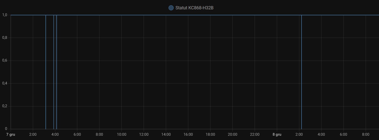

To confirm whether the problem I described earlier occurred only in one installation and concerns only one KC868-AIO controller, I decided to test the KC868-H32B controller at home.
After a few days of testing, I noticed that communication failures were occurring the same way.
For example, I show in the screenshot that the NIPPY driver and the raspberry server worked stably at the same time.
What could be the reason that only the Kincony controller loses communication?
