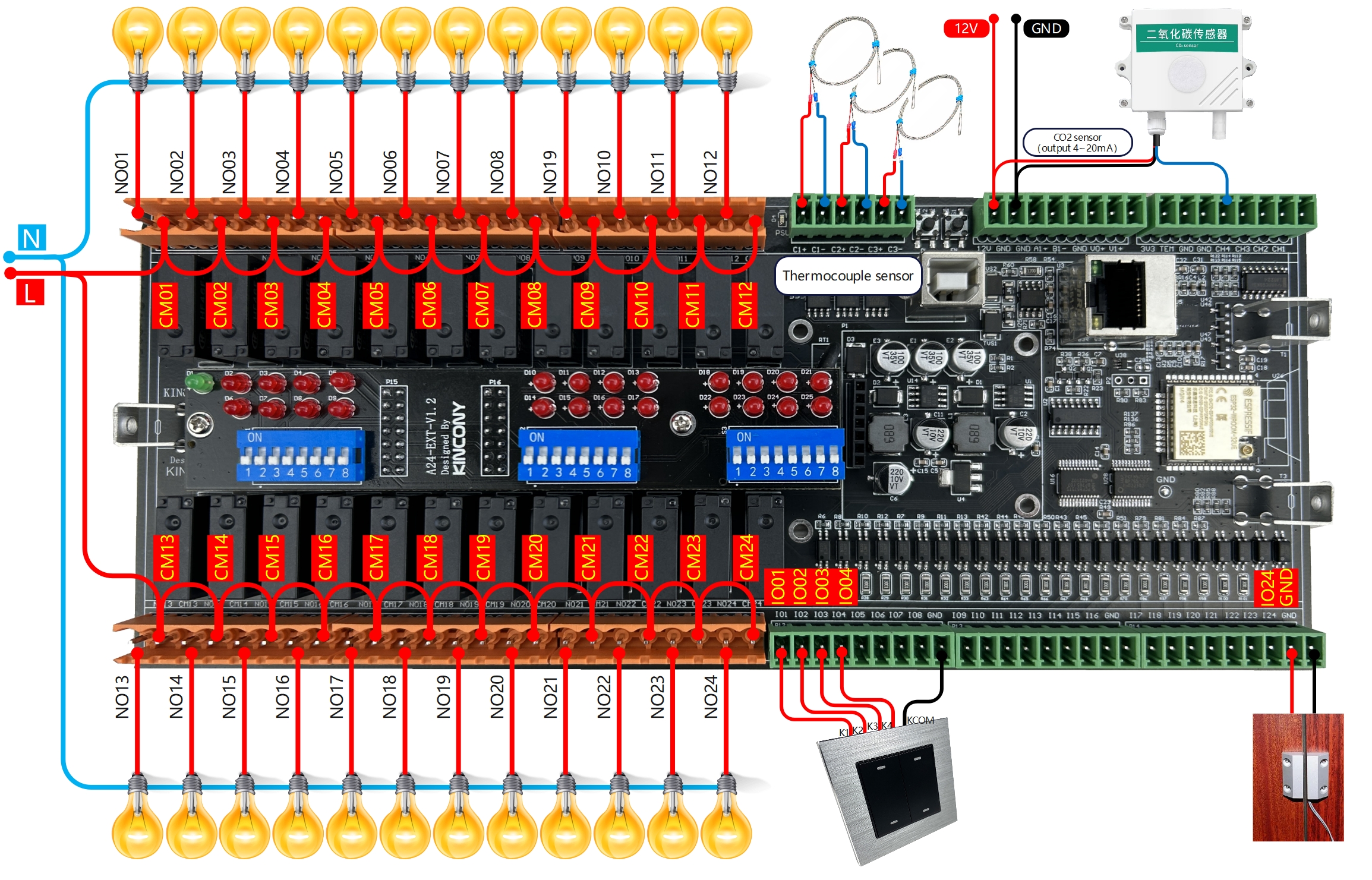

Hi, I am interested in making a panel similar to this one. https://www.kincony.com/32ch-smart-distr...stant.html . I need 2 breakers to be 32 Ampers. I only found 24v models.
How could I have a mix of 12v and 24v Ac connectors at the same time? I also see this excellent video https://www.youtube.com/watch?v=FE5fSduc0uI&t=597s . I only see 1 12v power supply. If someone could guide me. Great
05-28-2024, 01:47 AM
let controller's relay "COM" with a dc24v power supply, "NO" output to DC contactor's coin. so that can control ON/OFF 24v voltage.
My mistake sorry. So you connect the 220V L. to the A24 (in the coms) and then directly to the conector? Thanks!

hi.. So just the A24 as a bypass and connect directly the L to the COM and to the AC connector? Any recommendation like this ?
One for 32 and other for 25. https://es.aliexpress.com/item/330118466...pt=glo2esp https://es.aliexpress.com/item/100500379...pt=glo2esp THanks for advise.. Just want to be sure what to purchase
05-28-2024, 02:37 AM
yes, if use AC contactor, just use L to COM, so relay output to control AC contactor.
