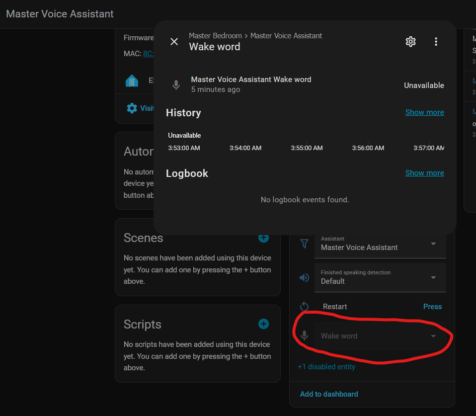

The Kincony AS is still not working on our side. On further investigation, we found that Wake Word is not available during configuration, as shown in the attached photos. Is this what causes 'Hey Jarives' not to respond, and how can we fix it?
