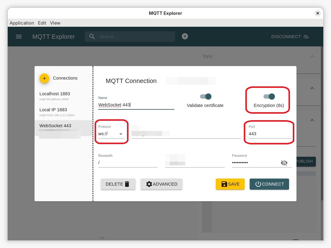

For additional info, we already tested our mqtt server using websocket over https protocol (wss://sub.domain.com:443).
it is succesfully connected.
