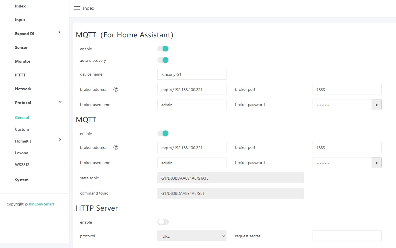

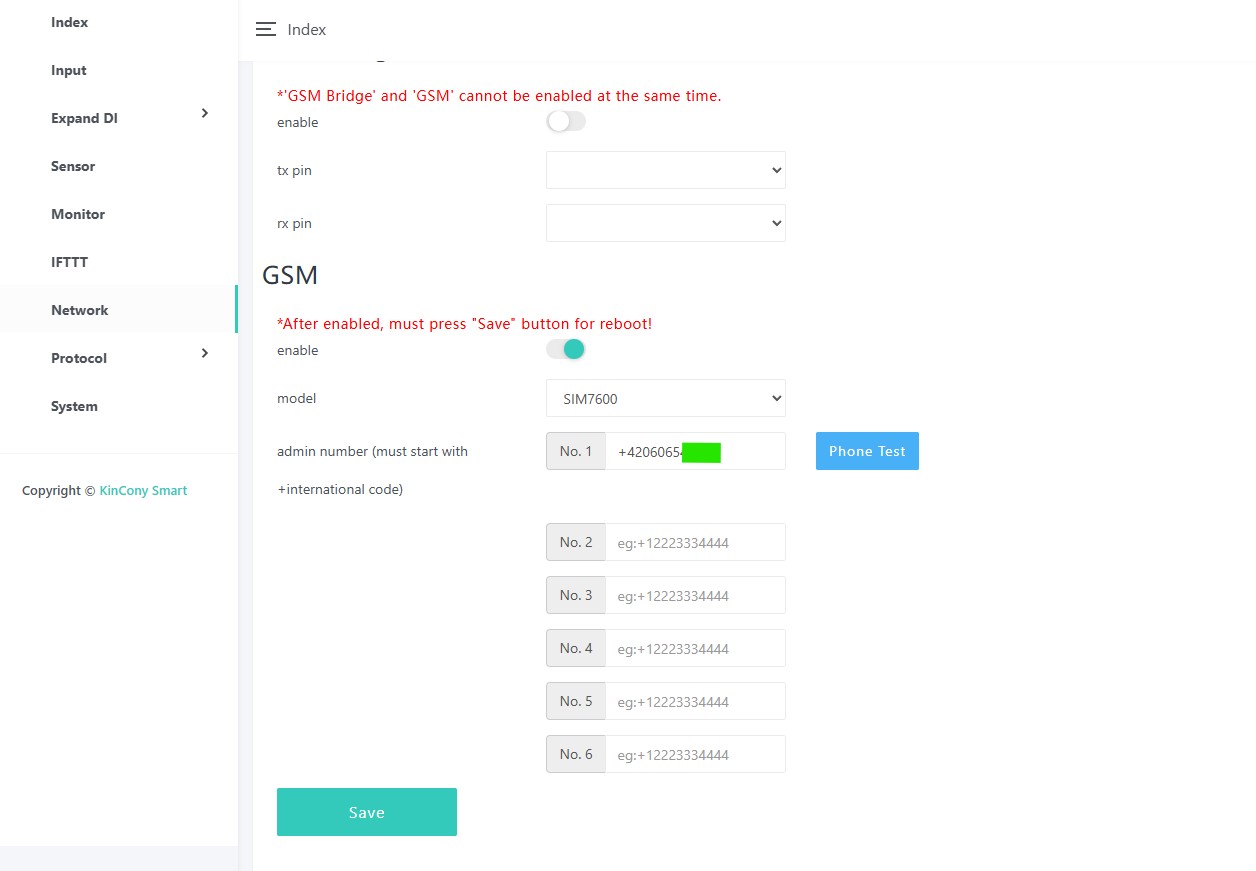

maybe you have not use the admin's phone number to send SMS. here are photo tested with G1:
use this KCS v3 firmware to test.
this step is important, must need enable 4G module, set the admin's mobile phone number.

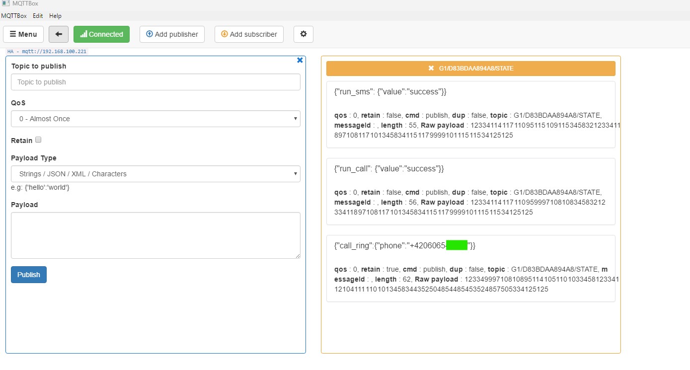

I can confirm via MQTTBox that:
  • run_sms → works
  • run_call → works
  • call_ring → works
there is NO sms_recv message at all when receiving SMS
This shows GSM → MQTT works, but sms_recv is not generated.
Screenshot attached.

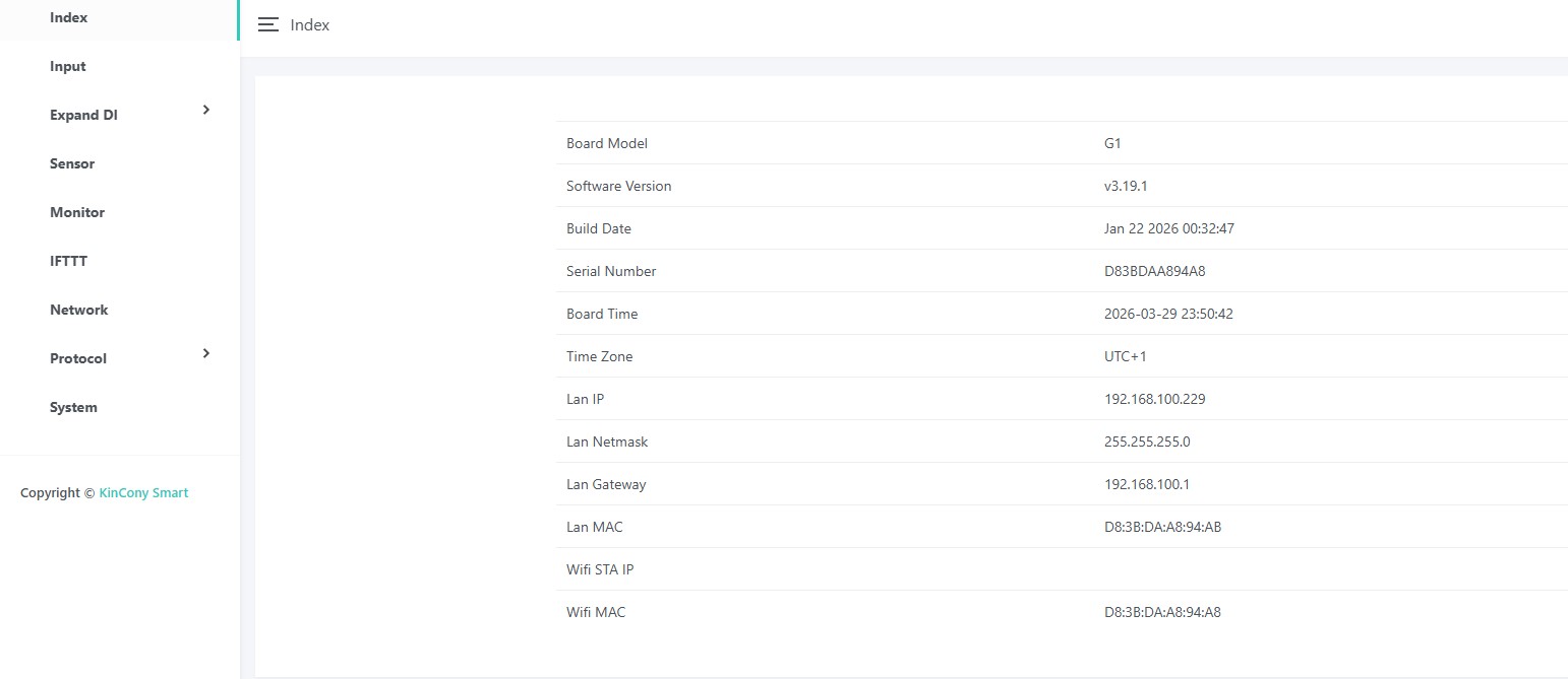

suggest you download newest KCS v3 firmware, at here:
https://www.kincony.com/forum/showthread.php?tid=9173

(I updated the firmware to the latest version as you wrote)
