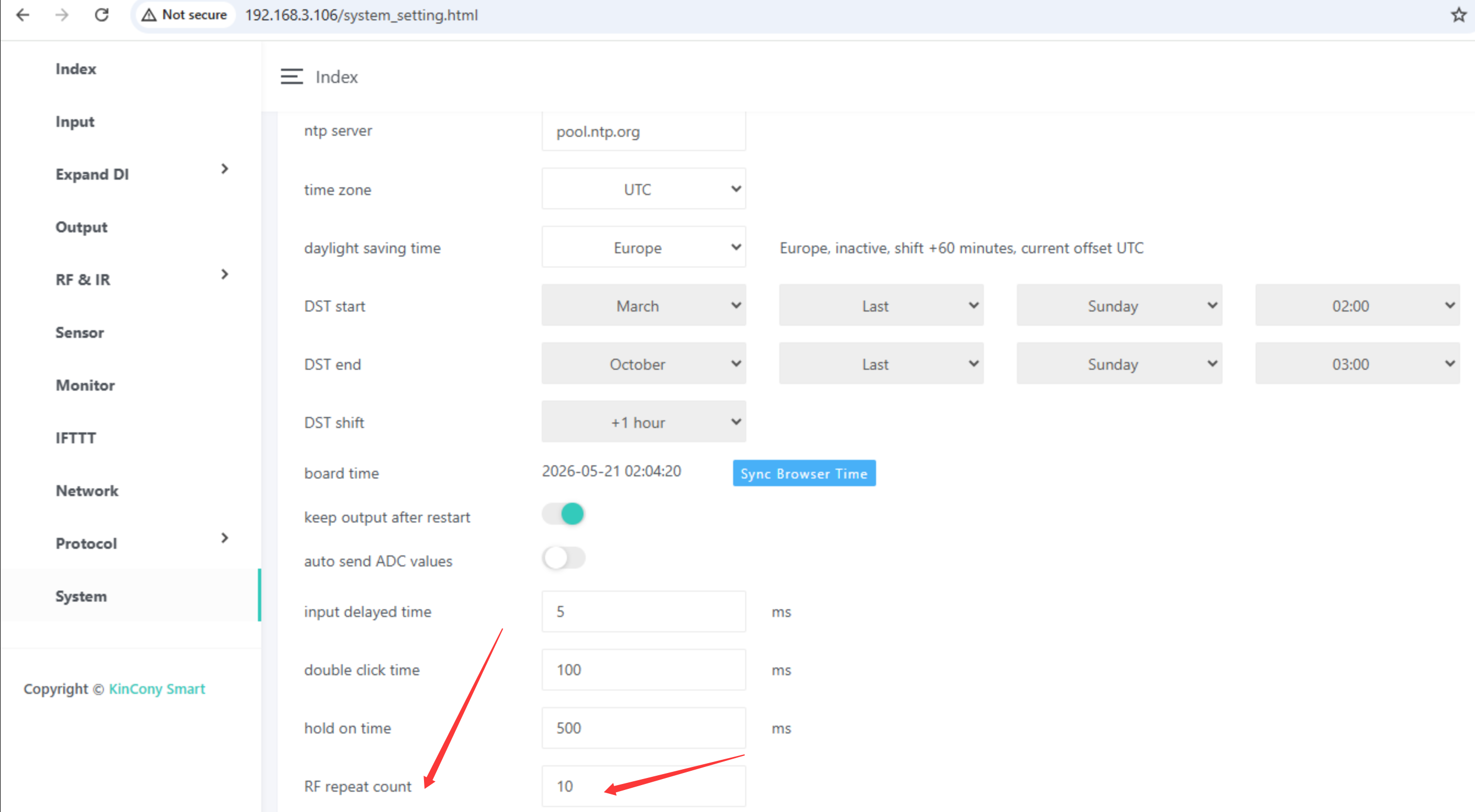

one last question, sorry.
I did get your v3 firmware installed and have successfully learned a couple of RF commands to control the light on an Altitude ceiling fan;  I would say kinda working as I have to fire commands a few times in quick repetition to get the fan to register but I'm very happy to get this far as this fan has been annoying to get working!! -  I'm sure I need to play with the rf settings a bit to refine..
my question is.. is there some type of verbose log somewhere that I can see/export that shows what rf codes are being sent when i hit the trigger button?
thanks again
you can set the RF repeat send times on this config webpage.
