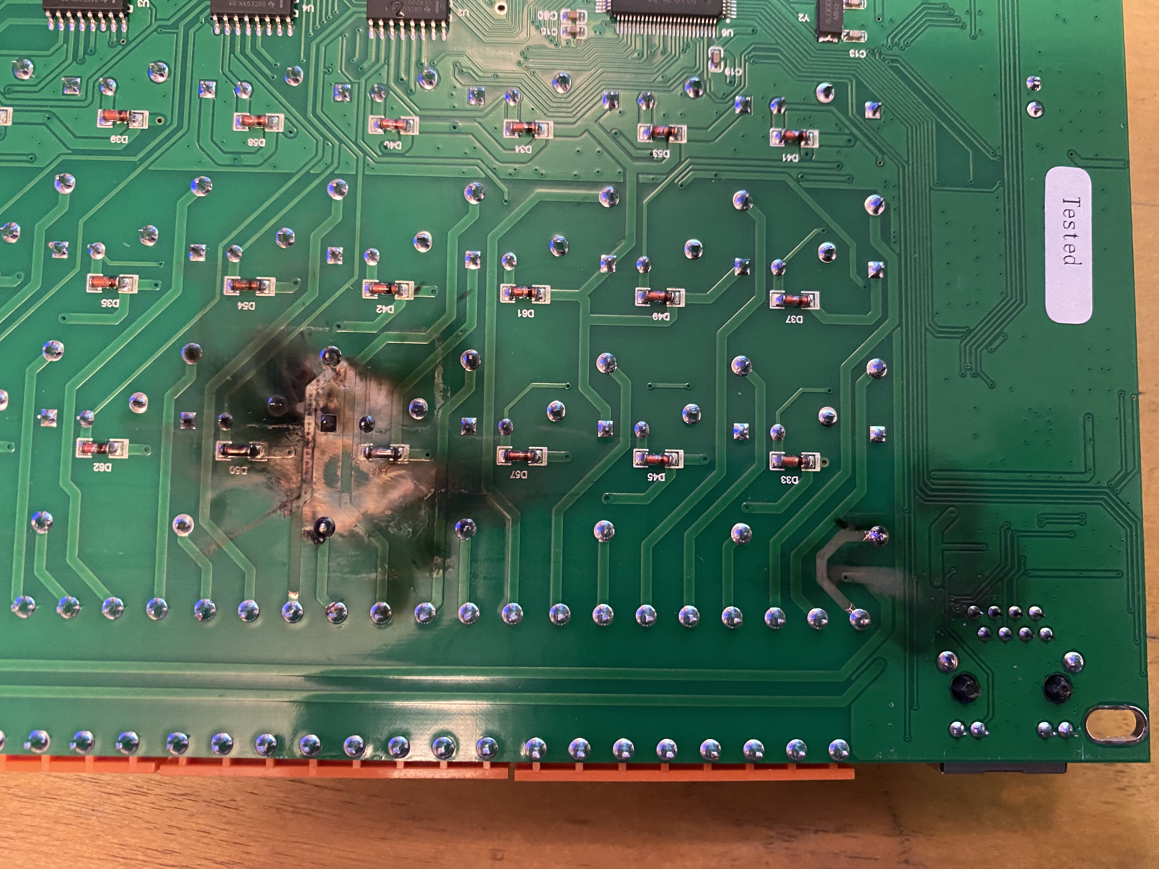

there are H32L and H32B all have broken?
03-09-2022, 11:37 AM
it have overload, we suggest you replace the PCB, if you want to try fix it. you can use wire welder with bad pin, because your PCB line is already disconnected.

Hello Admin,
Many thanks, My own fault, have been give a little money off my wife to buy another, However this time I'm going to put full protection in, I do have a few questions first, as designing my system now. Do i need contactors? Gary
03-10-2022, 12:57 PM
i suggest you chose H32BS + KC868-E16 extend relay module, it's the most stable way. if your load current >10A , suggest add contactor, contactor is most safety. I think you very love your wife
