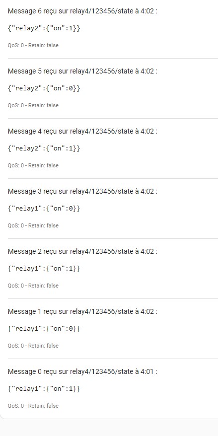

(03-04-2023, 11:04 PM)admin Wrote: your relay board connect to mqtt broker server, your home assistant also need connect to same server by mqtt.
thank you, I have a connection of the card, I can listen to the topic and order the relays
