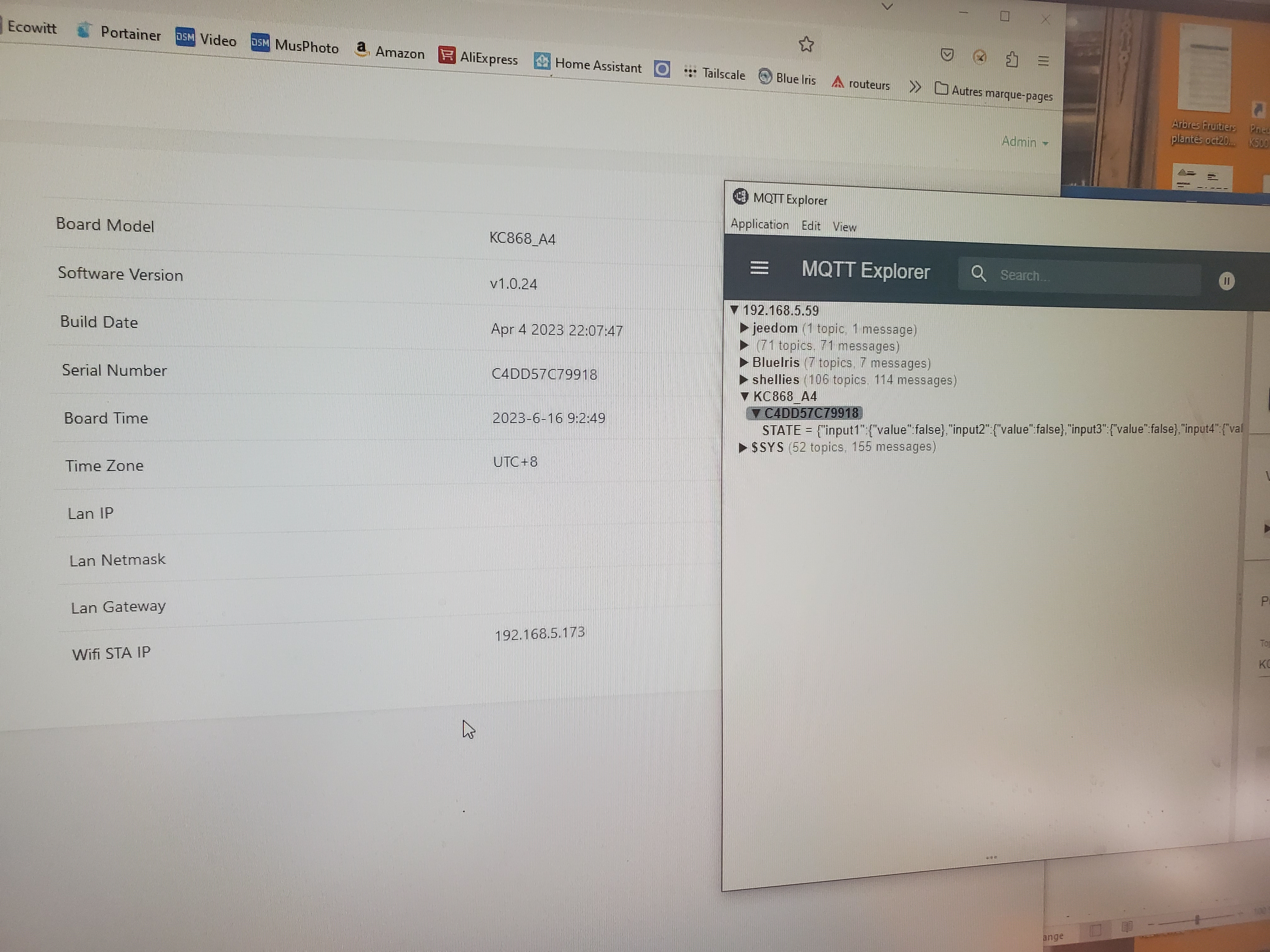

My video do not upload (80Mo). I am sending two pictures. Thanks

Let me rephrase my problem. Yes in one Mqtt frame , I get everything updated ( relay,input,analogic...). The problem is that this frame is only sent when a relay or digital input changes.
If only an analogic input changes, there is no mqtt frame being sent. This is what one of my pictures shows.

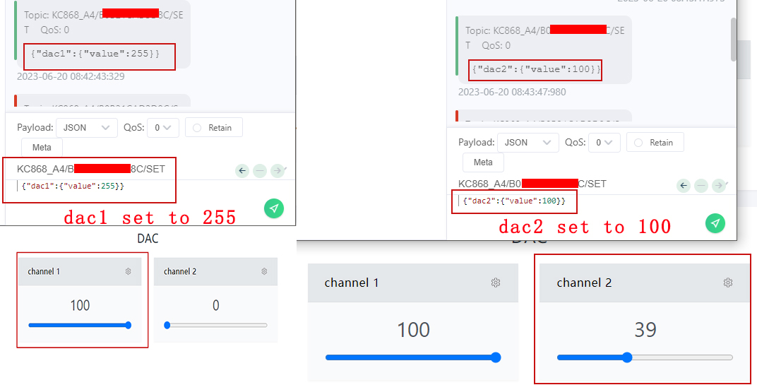

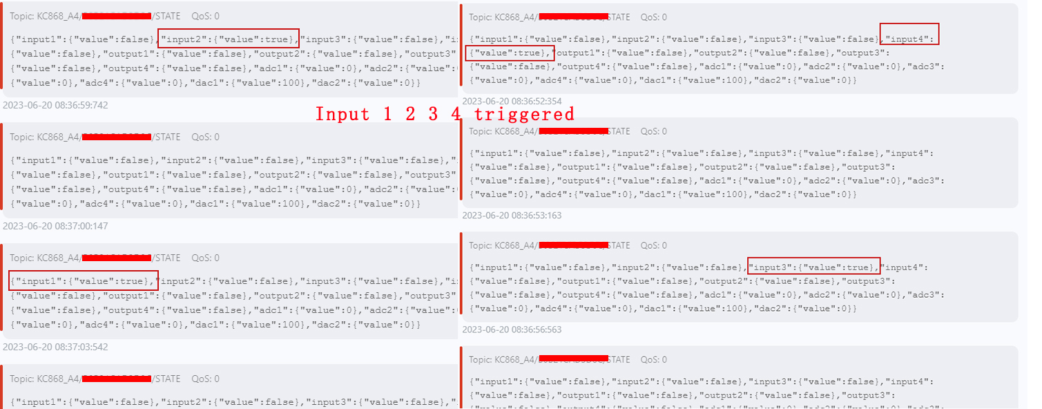

I Was test the problem,KC868-A4 power on and do nothing,just set the value of Analog4 when the value up to 2000,it will send mqtt command,no relay control no input trigger,when analog 4 is connect to 3V,it will send the value about 2596 .See the picture below.
