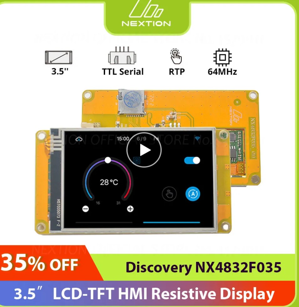

How can I connect A8s to Touchscreen pass TTL Serial ?
Please suggest....
Please suggest....
can I connect A8S to Touchscreen by TTL Serial connection
07-24-2023, 02:59 AM
A8S no free gpio for use serial port, unless you can use RS485->serial TTL converter module.
07-24-2023, 03:42 AM
07-24-2023, 03:48 AM
sure, but the level is 3.3v, your LCD maybe need 5v TTL level, you can try to test.
