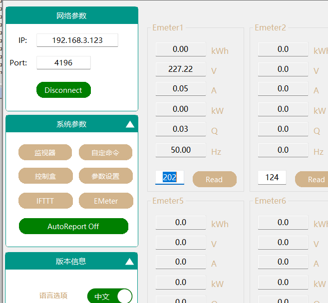

Uploaded new firmware but no data is loaded when pressing READ meter data. Very strange.
In the mean time I've connected MQTT-Explorer to my Mosquitto broker hosted on Home Assistant and checked if any data is sent, but no data is received.
I have 2 other COLB devices with version 1.14 firmware and they are sending mqtt data. They are OK with 1.14, but when I download a newer firmware (2.4, 2.7, 2.8, 2.9) they immediately stop sending meter data and mqtt data. Why?
No setting are changed, nothing! Only the firmware.
Very very strange.

Now the meter reading is OK, but still no data is coming to mosquitto broker in Home Assistant.
In Mosquitto broker logs nothing appears from the COLB.
It has to be something like this "New connection from 192.168.1.75:4196 on port 1883" but there is nothing.
If I publish something to the colbs topic it appears the message in mqtt explorer but from the colb's side no data is flowing to the mqtt broker.
