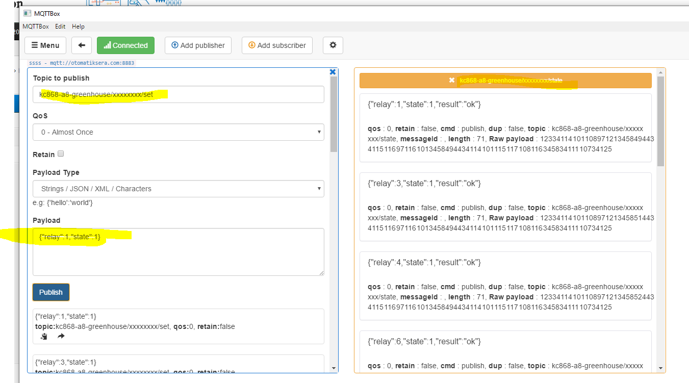

I am using kincony A8 board with my local mqtt broker..i have successfully connected board with mqtt and tested relay output using mqtt commands.....
   is there any way to check my device is online or offline ??? online /offline status of kincony A8 client .....??
now not have this state feedback, in furture we will update "KCS" firmware to support it.
